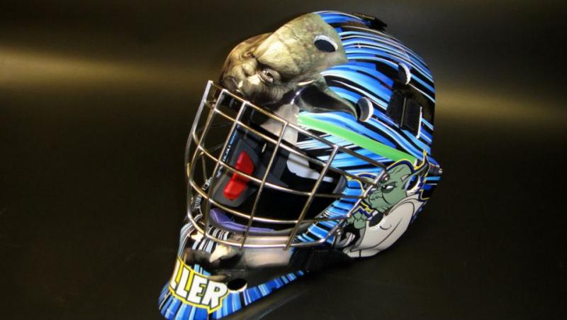

Piece of cake. Two pieces. 3 if you include the unattached back piece that tightens around the head. Using Avery MPI 1005 EZ. Selecting the material is key. NO primer used. "Fear is the path to the Dark Side." :)
formanek

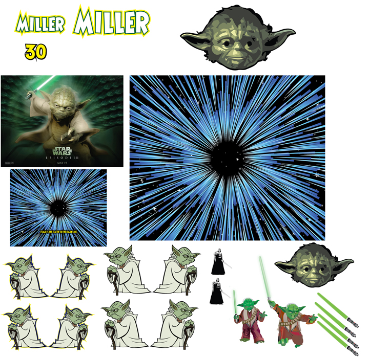

Printed big panels. Seams are covered with the light sabers on the sides. Two pieces total for the main helmet. The back piece is one more. The entire thing is cleared with automotive clear to save from drops and puck hits.
Sorry Yamaha581 I couldn't get an image into the private message. Others may do these a different way, but this works for me because I don't have to mess around with trying to make different templates for all the other helmets.
