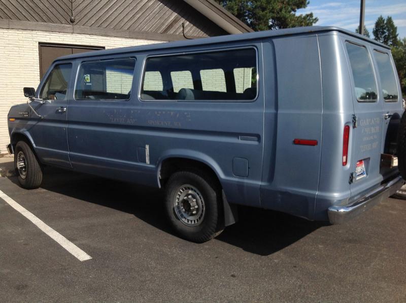

Here is the van. Old and dried out :)
SightLine
Ick and extended window van. Little more of a pain that will add to the cost some.
