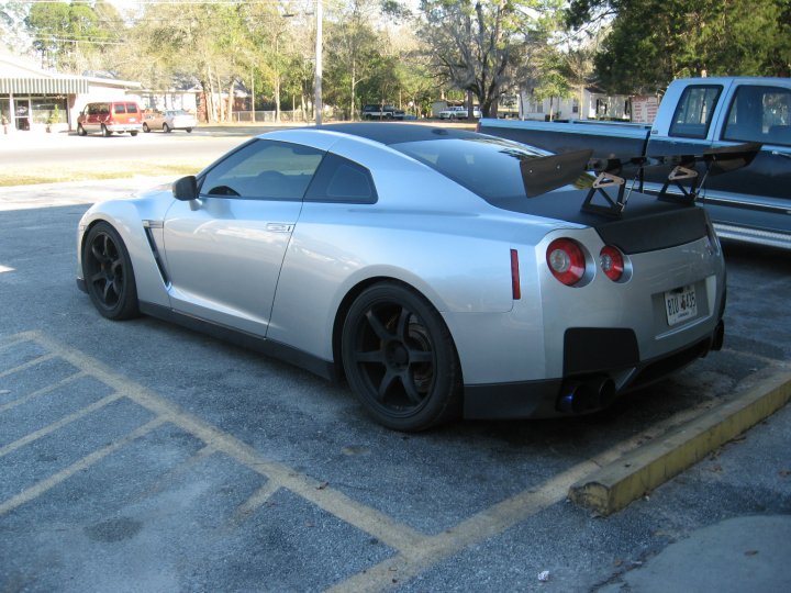

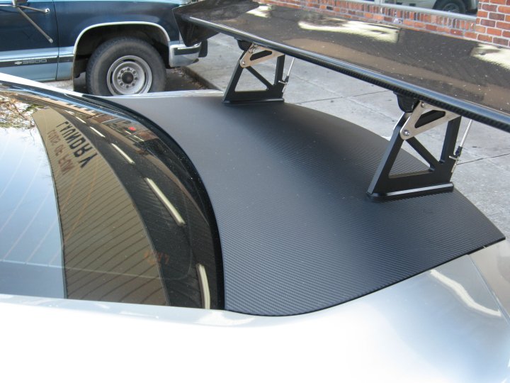

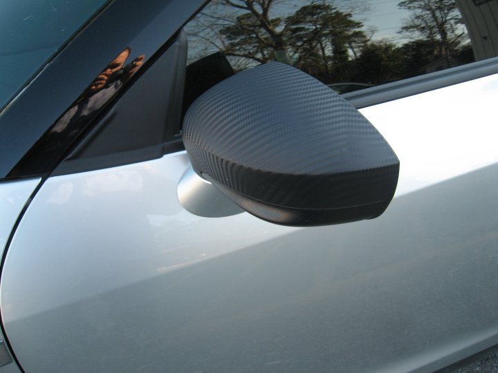

We wrapped the mirrors on a Nissan GTR with carbon fiber dinoc, but we left them on the car. We also did the trunk roof and other accents on the car. The dinoc is pretty easy to work with. Just start as close as you can from the center of the mirror and work outward. Do be careful when heating and or stretching though, it's fairly easy to distort the pattern/texture.

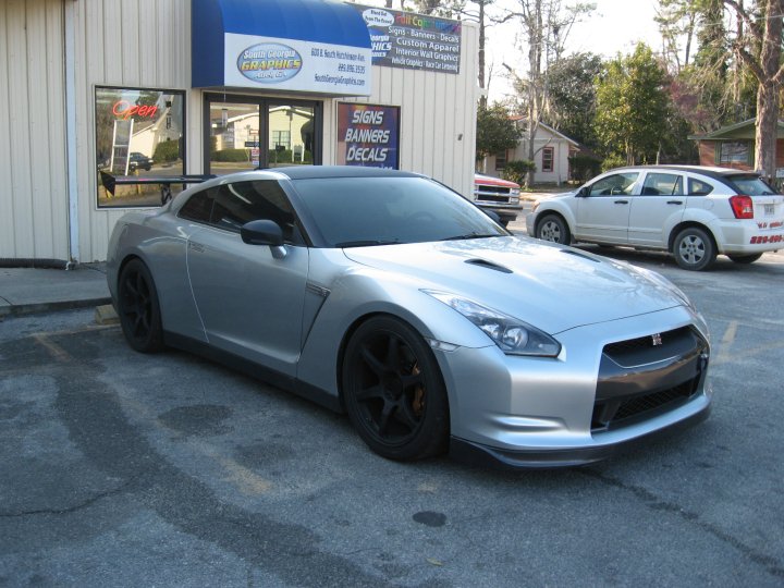

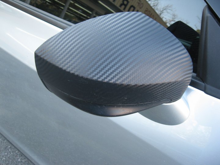

Here is another shot. He actually road races that car. Sorry, didn't mean to steal your thread.
sghobbies

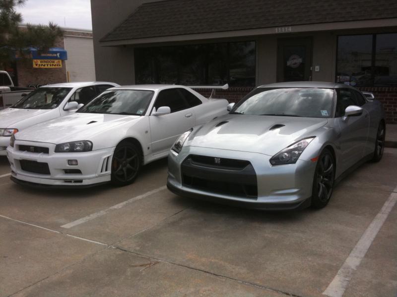

Wrapture
Funny I clicked on this. Here's what was in our parking lot 2 hours ago. Very, very cool cars.
