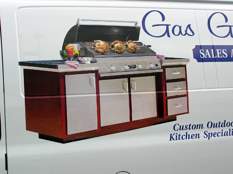

Not exactly a wrap but the attached photo of the grill is three panels with a .1" overlap on each panel. It was Edge printed and had UV/Abrasion Guard overprinted. It was applied from the bottom up with wetting solution and transfer paper with the bottom .5" left unmasked.
