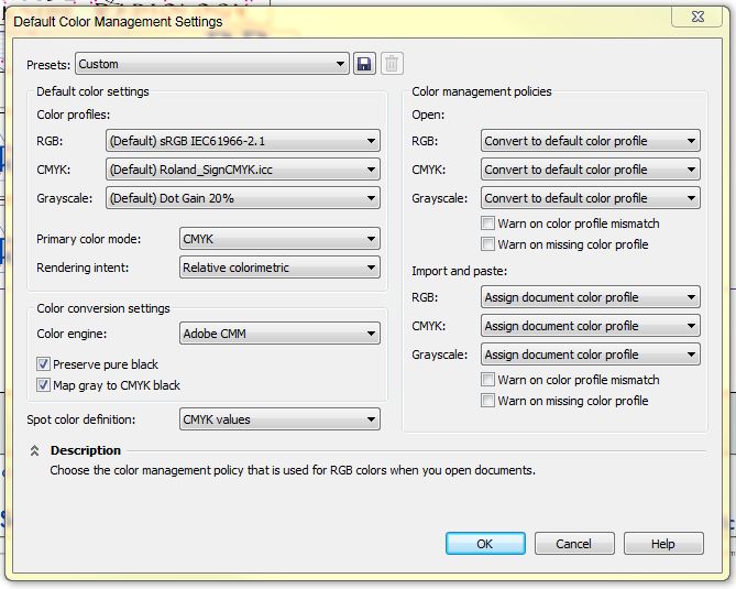

I haven't tried that, I'll give it a shot. I can't believe that "off" seems to have been removed from all selections. I hope I'm just missing something simple.

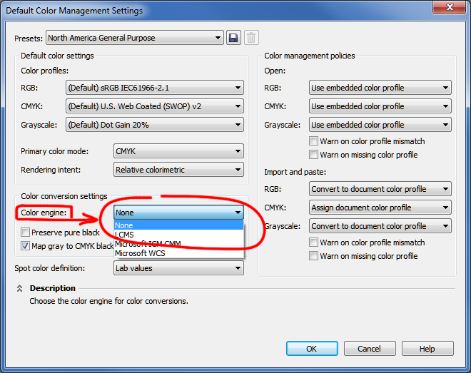

Sure thing, here you go. I spent the last 1/2 hour trying to find out how to turn color profiles off, but I haven't found it yet.
Try Converting every thing to RGB as per attached.
The trouble is that X5 introduced truly professional Colour Management and the default palette also changes.
If you are still having problems try posting here there are some Heavy Weight Colour Gurus that hang out there one being David Milisock who has written a book on colour management in X5 http://www.graphictechnology.com/foster.html
