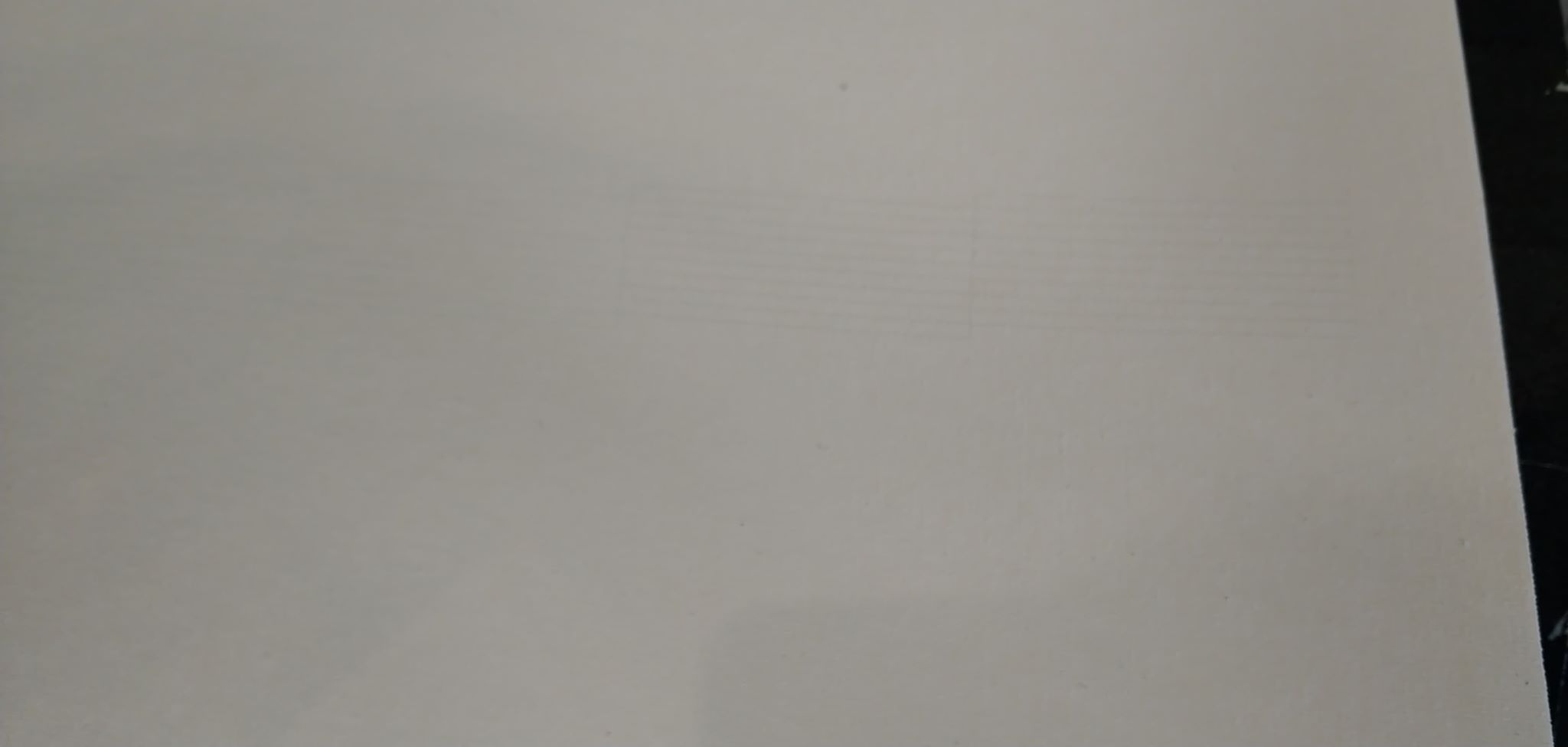

MandyProto

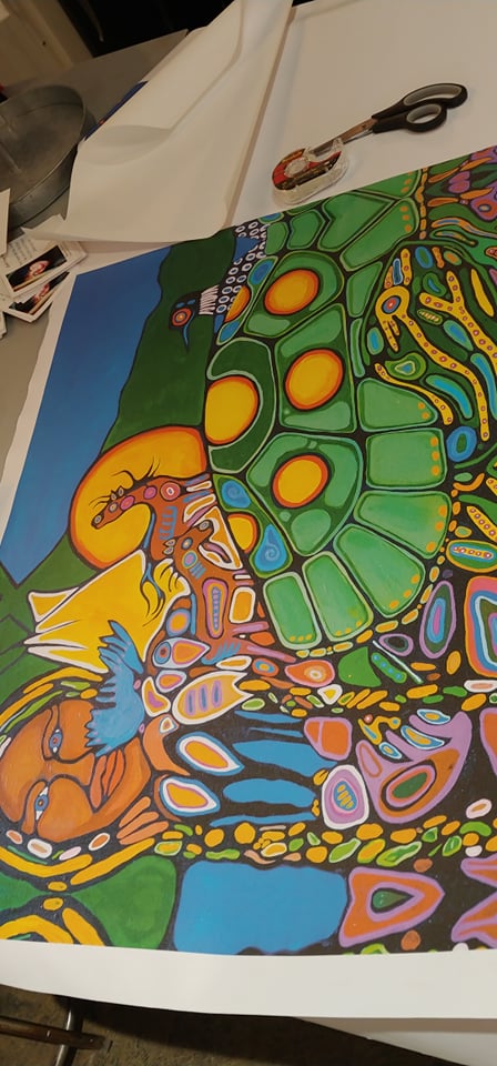

MandyProto
this is what was printed prior to this post, the reds are orange

Solventinkjet
DIY Printer Fixing Guide
Yeah that looks very light. If it were me I would just do a maintenance on the machine which would include changing at least the cap top and dampers and maybe just the whole maintenance station especially if these parts haven't been changed in multiple years. That would rule out maintenance issues. if it continues you might need to soak the head.
