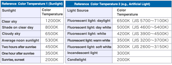

No. The color temperature of sunlight changes throughout the day. At its brightest during midday it will be around 6500K. The color temperature can go higher on overcast days. By sunset it's around 3000K. Professional photographers often carry a gray card in their camera bags to set custom white balances for shooting both indoors and outdoors.
At any rate, it's still a good idea to make printed color samples for any big job and at least proof them outdoors to see how they'll look in the sun. I've seen custom light boxes with different color temperature lamps rigged up to proof print samples under different lighting.
6500k is called daylight when you buy bulbs. Look it up and tell me I'm wrong.
