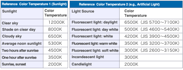

In the first image these two seem counter-intuitive:
  • Cloudy sky 6500K
  • Average noon sunlight 5300K
Is it possible they are reversed?
No, that is correct. 6500k is closer to an overcast day because it is pushing into blue a bit more than 5000k. Remember it isnt about brightness, it is hue.
