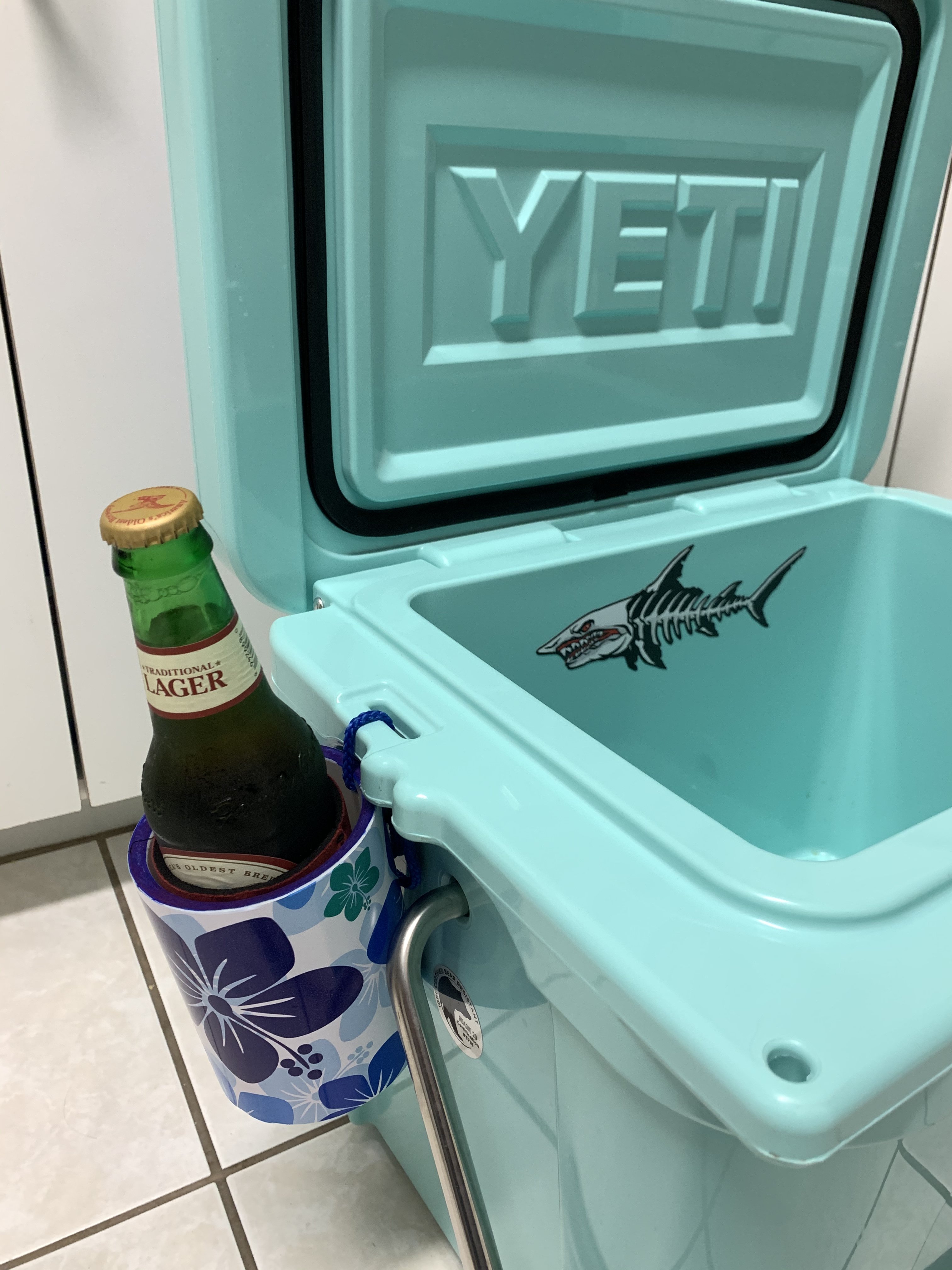

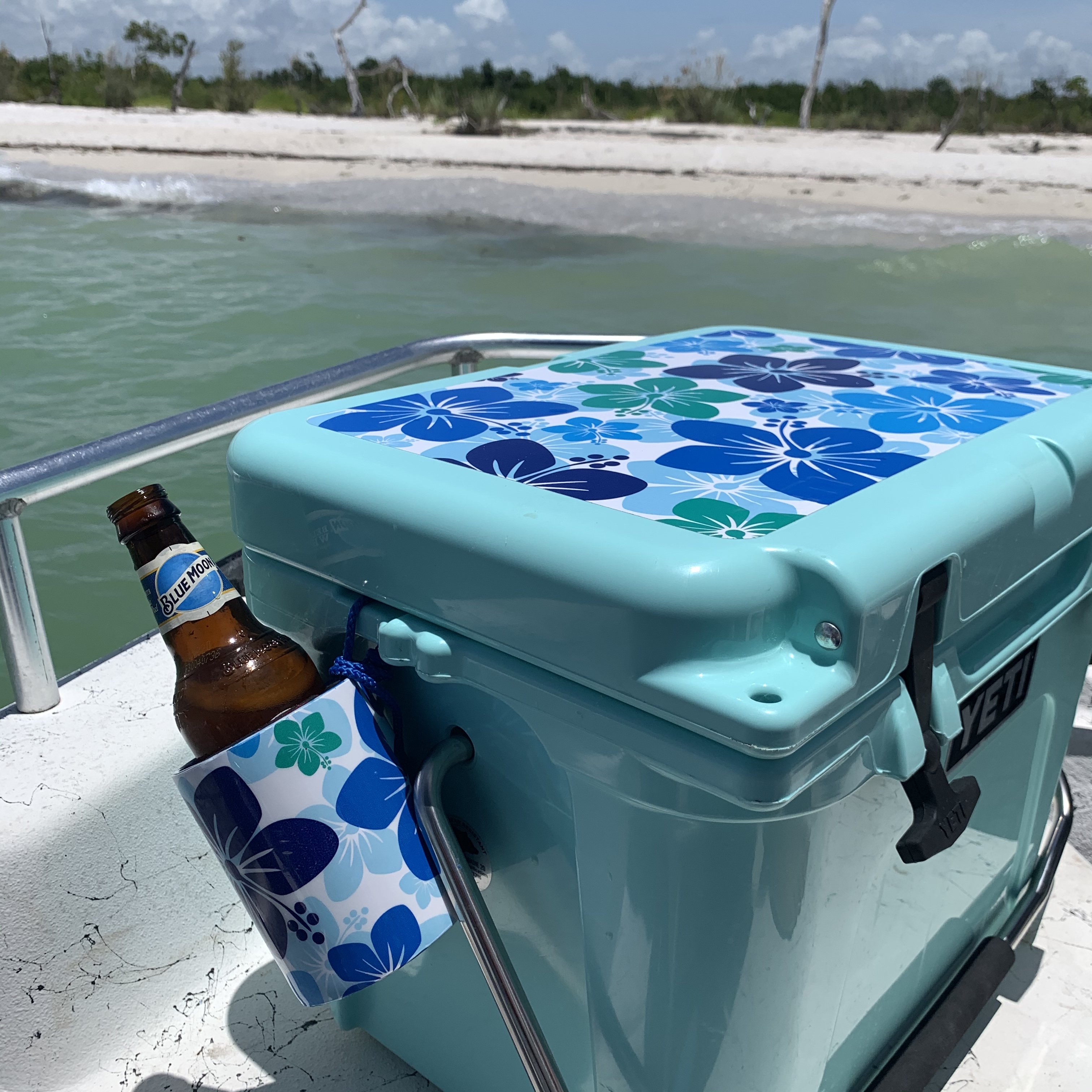

    I use orajet 3551ra and it sticks just fine. I also make stickers for the inside with it of course laminated in/out usage. 473FAE80-3BA1-48A8-8C7B-104DB4310E24.jpeg 8C0A8D58-55A2-4F3F-BA42-CC7A6F6FF32E.jpeg
