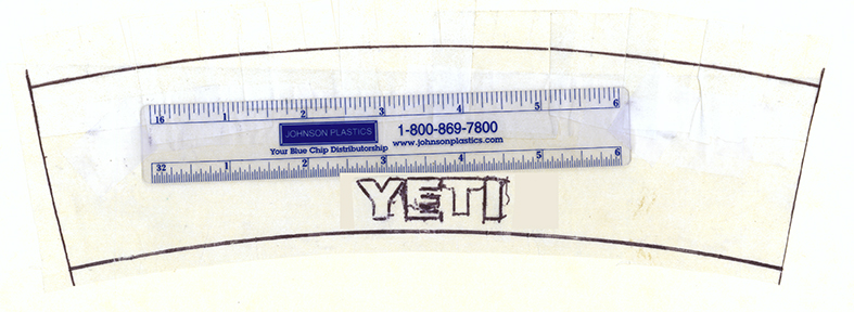

Does anyone have a template for the Yeti tumbler cups, or know where to get them? I was going to just make one but if I could save the time and just buy one that would be great.
How to make a Yeti template I just wrapped the Yeti cup with application tape, used a plastic drafting 30-60-90 triangle to make a vertical line for the seam both on the starting edge and then on the overlapping end, then using a piece of cut 2x4 cut 12" long with holes drilled through it to hold a Sharpie at the correct height (top and bottom), I placed the 2x4 (vertical) next to the Yeti cup and and rotated the cup, the Sharpie marked a line all around the top edge and then the bottom line on the cup.
I then removed the app tape (carefully) and stuck it down on a piece of thin cardboard, placed a transparent ruler across the outlined pattern and scanned the image. In PhotoShop I enlarged the image to full size, now you have a full size template.
