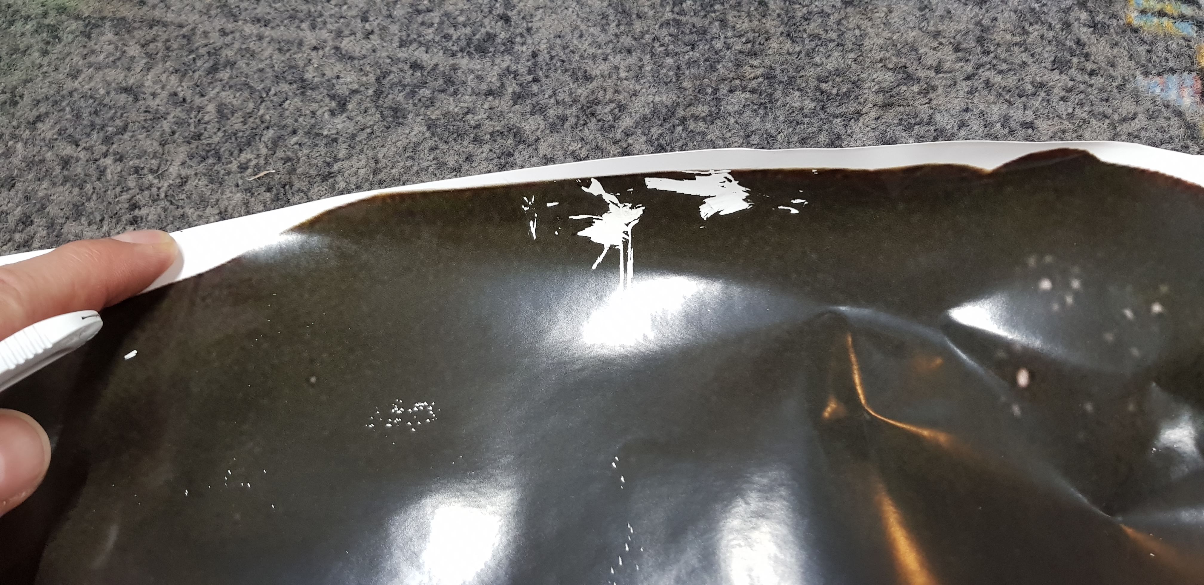

Hello,
I am new at this forum and maybe I did not manage to find answers for my problem.
I have bought new HP Latex 315 printer and I bought Avery Greenline GP3400 Gloss vinyl for making decals. Thing is that there is no profile on Avery site for my printer and I copied similar one, but print is not dry after it is finished and it scratches and goes off. I tried to dry it with heater/fan but no luck.
Do anyone uses this media on Latex printer?
Or know which parameters to use (optimizer, heat temperature,...)?
Thank you very much, Bostjan

Avery Greenline medias are non -inkjet coated polypropylene films. They are not presently listed on the HP Media Locator, but that does not mean that they are incompatible with HP Latex printers. I have run similar films with success, by using a relatively high pass count, combined with relatively low curing temperature and moderate ink density. The key with HP Latex is to craft balance between these three variables. Here is a video on this topic:
Any current HP Latex printer can be used for this, including those that lack the on-board spectrophotometer (the 115/ 315/ 335) - note that the ICC Profile will be auto-assigned by the printer, rather than custom-generated.
