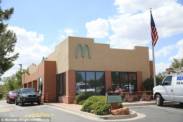

It looks like even if you have McDonald's level financial resources you may not win.......
http://www.dailymail.co.uk/news/art...nt-s-not-fast-food-giant-s-unusual-store.html
I'm lovin' it???
I'm lovin' it???
wayne k
guam usa
Don't believe everything you read on the internet. That McDonald's has been open since 1993. The franchisee, the town, and McDonalds all agreed to go with the turqouise logo just to be different. If McDonald's had forced the issue, it probably would have been just fine to be yellow. Sedona, AZ is a different sort of town....
