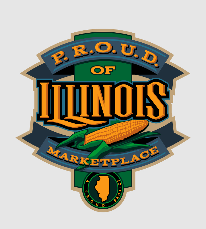

Well, unfortunately it's a no-go on this one. The "committee" has spoken and they want to loose the Lincoln, replace that theme with the ugly shape of our state, some corn, and of course the colors of our high school... Orange and Blue.
Don't get me wrong, I'll somehow figure it out, but I thought this one turned out great, it will be sad to see it go unused. At least it will find a nice home in my portfolio.

Ok....
we've got our orange and blue,
we've got our corn,
we've got our state shape,
and we've got a name change.
Time to clock out for the day. I'm out. :toasting:
I did the double "L"s that way on both designs, because I don't like the empty space that upper case L's create. This way I can pull them in closer.

Oops! I just noticed you had to revise the original and go with a new approach. Unfortunately it no longer looks as touristy, eh? It's a shame. I like the original Lincoln design so much better. The blue and orange definitely breathe Illinois, but the corn makes it look more like a produce market. It sucks when the people that ultimately make the decisions make poor ones, which is what I think is happening here. Oh well. Like you said, at least it'll be great for the portfolio if they somehow don't see the merit in it.

Nope, nope, nope. That state shape is not big enough, needs more cow bell!
Sorry, couldn't help it:Big Laugh
I don't know how you got that all in there.

Joe you're one of the only people I know who could have made that work lol only criticism I would have is to maybe lose the black shadow on the words "proud" and "marketplace". I think it makes it hard to read and throws focus off the main objective a little bit. Try it and see if it works! Just a suggestion, looks great!

It is a shame that "know alls" get their way, but I must say the "L"s make it look like a bunch of "I"s all in a row.

Man that corn looks excited to be from Illinois!

Looks, great. My only comment is there are an awful light of line weights, highlights and shadows and it could possibly be simpler. Might also suggest the main corn leaf not be in front of the bottom foreground shape so there isn't as much tension where it interacts with that small type.
Killer work as always.

Don't you hate it when a superior concept dies by committee? Worst part of the job.
The "A P.R.O.U.D. PROJECT" at the bottom has too much space between the words, bring that closer. Otherwise...looks nice, just not as nice as the original concept.

They liked the changes but wanted to maybe add "Pontiac Illinois" and a rt.66 shield too. I said the only way that is making it on this design is if we substitute it for something else. There is already too much going on. One more element will kill this layout.
My contact asked me how I liked it. Usually, when the client ignores my advice multiple times and they ask me a question like that, I usually say "I like it if you like it". I think that's kind of what they want to hear and at a certain point it is no longer worthwhile for me to battle the client about their own image. But I really do want to see them make the right decision for this brand. So I told them I liked the first one better. I doubt that will make a difference though. I think in cases like this it's more important that everyone on the committee got to put their mark on it. So we'll see.

And that is why we end up with designs that need to incorporate 5, 6 or 7+ elements.......along with making it look good :rolleyes:

the original design would suit them much better as you already know, when i saw it first thought i had was a younger colonel sanders and was hungry for chicken all a sudden...:rock-n-roll:
on the committee making decisions... i read someone on here once say something about how we as professionals are the ones doing the design work and then having a person that has no idea of anything design related make a decision on what to use and not use, kind of defeats the purpose of having a professional do it.... i don't remember who said it, but they were much more elegant in the wording than my attempt to reiterate it right now

When I was a tattooer, that's what we would call "ten pounds of 'stuff' in a 5 pound bag. In cases like that, when design requirements got extreme and there were too many elements involved, we either told them to go with something simpler or go with something simpler. There is always that fine line where the design can start to weigh you down as an artist and make you look bad. When people's skin is involved it can become more of an ethical decision on the part of the artist. When you're dealing with graphic design, on the other hand, the customer probably doesn't care whether you think it's too much or not...unfortunately. As an artist you have to sell their image but make an image for yourself as well, and that can make design decisions like these difficult, for sure.
My thoughts are that "P.R.O.U.D." doesn't need to be repeated twice in the same design. Also, did you try replacing the green rectangle with the shape of the state? Just a thought. Maybe that will lighten up the load a bit if they will go for those suggestions.
Totally agree, and was suggested.
With all the stuff that would be in front of it, it wouldn't be recognizable as the shape of our state. It would just be this weird lopsided shape that throws the design's balance way off. Weird shape I could deal with if it were a bit more symmetrical and made a bit more sense from a layout perspective. Since this design is meant to attract travelers, especially those from overseas, I wonder if it will ever be anything more than some weird shape to them.
I made the state really small like it is mainly so it won't compete with the more important content, yet still be included in the design thus making who ever suggested it be included happy. I wouldn't have included it at all and I originally didn't.

The first one is great. It takes about .025 seconds to read it and process the text and you "get it" immediately.
The second one is also great considering what they had you cram in there. It definitely takes longer to read and understand though...maybe they'll realize that and pick your first design.
Nice work.
