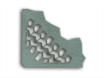

what are the chevrons for?? I'd try it with a big fat tire tread there.
Tire tread is difficult to laser cut in steel plate. The chevron is a tie back to the owners military back ground. I have made a couple parts over the years with a tire tread laser cut into them. The cost is high because of the time needed to cut the part, you can not cut it very small, and most of the time it blows the back side of the part out.
the attached pic is a piece of 3/16" steel plate. It measures 3 inches on the flats. This is about as small as you would want to cut the part. The back side on most of them does not look too good. The reason it is difficult to cut is because of the amount of heat that builds from all of the cutting in a small area. BTW... this is a gusset to weld a corner for added support.
