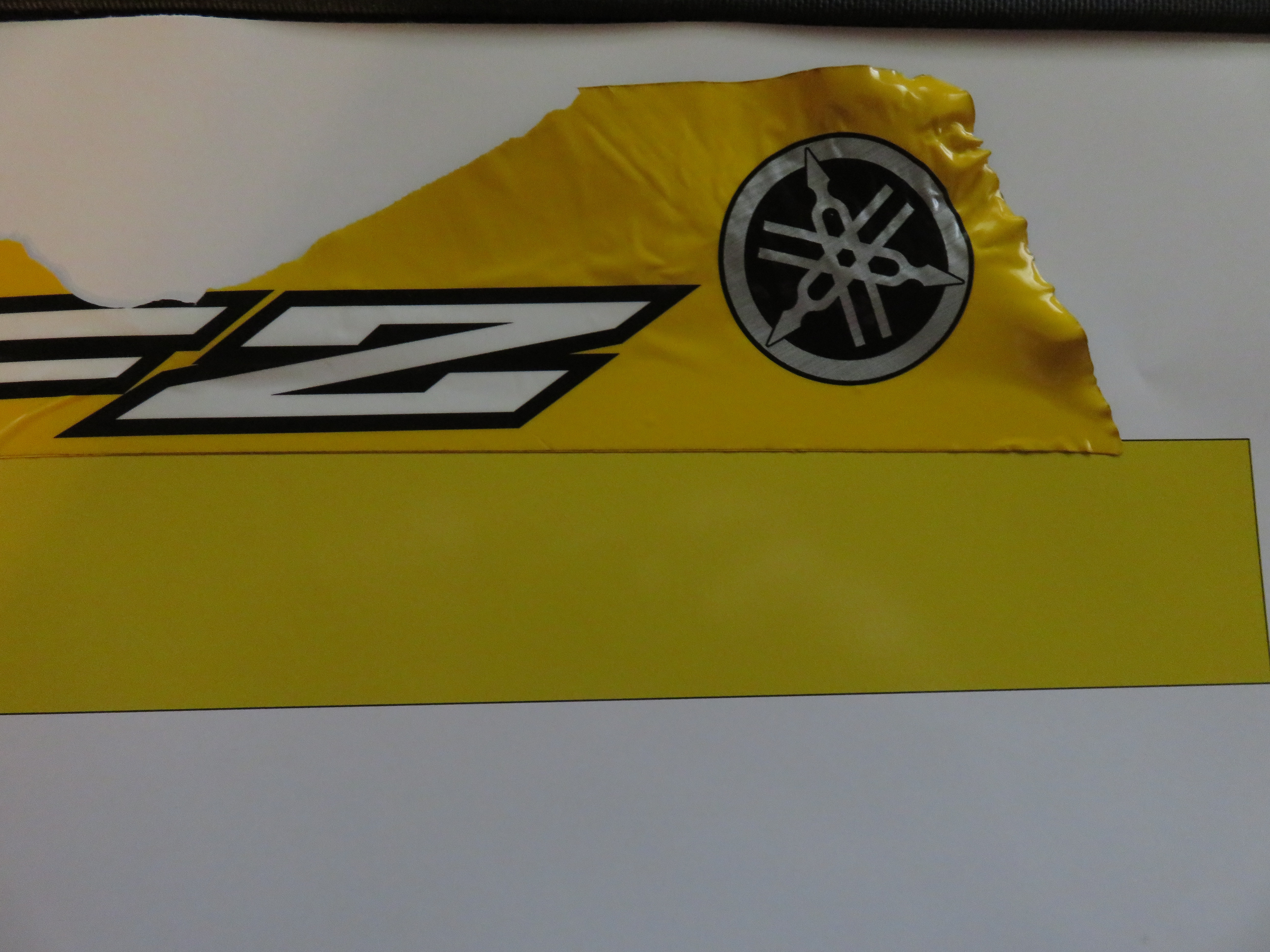

I've been at this for about a week , I've printed 2 color charts and can't seem to get the color I want .
I am attaching a picture hoping someone has a value I can use that is close to it ?

Found this formula online for Munsell Yellow
C: 0
M: 17.6
Y: 100
K: 4.3
Of course it will be dependent on both your media and printer calibration but hopefully it'll get you closer to the mark.

Thanks , What mode under quality do you print this ? I normally print in Mas Impact .
SignMeUpGraphics
Super Active Member
We haven't used a Roland since we got our Epson, but I think Max Impact might skew those numbers a little as it tries to optimize bright colours from memory.
See how it looks in that mode otherwise try Sign&Display which should be a bit closer to 'accurate' colour.
