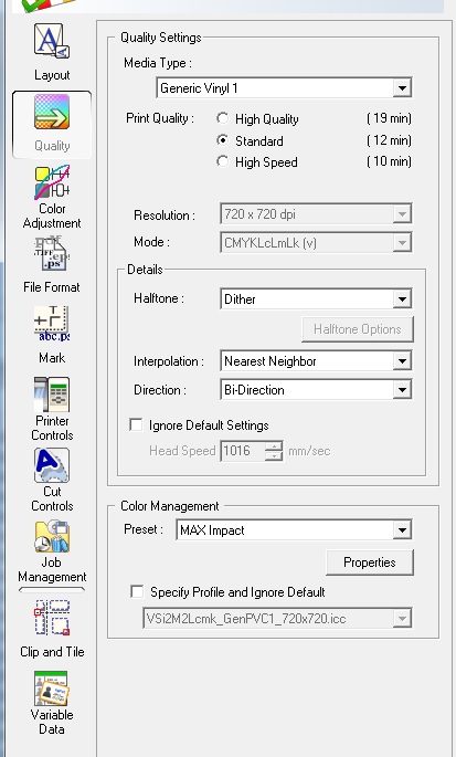

Here is a picture of my current settings .

As you can see from my print settings I normally print max impact , all of my jobs are RBG or CYMK and I export to PDF
