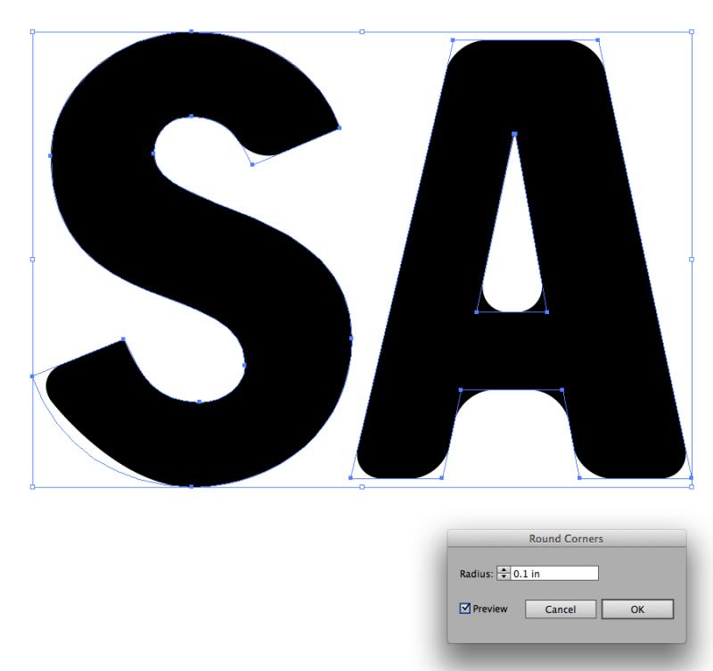

Here are 2 samples. On sample 1 i used Illustrator's built in rounding corner effect. It misses some corners and also tries to round off curves. I only want it to round the points. The script version shown in sample 2 is correct. The only disadvantage to the script is there is no preview so you have to undo and redo until you get it right
