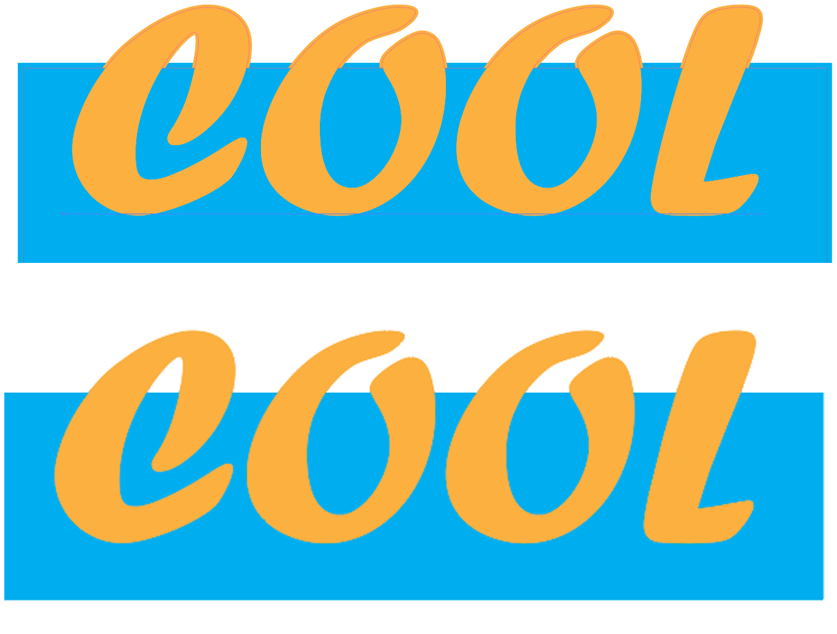

I think negative offset path is hard to beat. This example was made from a pretty bad original cutpath so would be better if made from a good original cutpath
I get what you're saying, but in that example some of those results wouldn't be acceptable. (and not because you just did a quick auto-trace)
On the inside of the "s" for example, the finished product when weeded would result in some wonky shapes/intersections of colors.

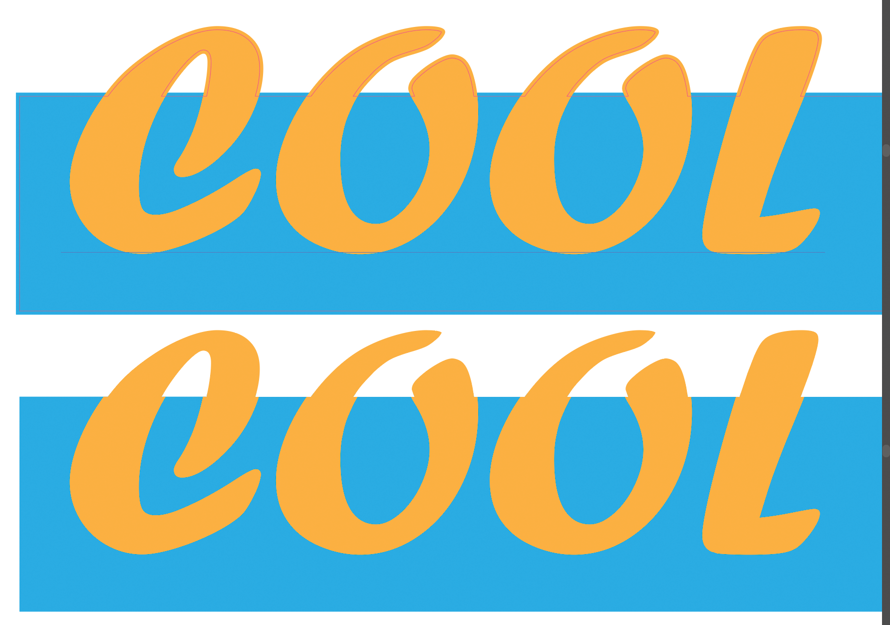

Doing an offset alters things like text, it might or may not be noticeable but it is still shrinking everything. What if you have a 1" stripe, it's not 1" anymore unless you make a proper bleed. You also have other situations like offset printing that usually have a pretty fat bleed where an offset path would not be sufficient without really cutting into your artwork.
Boudica
Back to "educational purposes"
Here I have done the offset, on the inside to create a bleed, once it's cut it looks stupid.
This is an example of placing the bleed behind the artwork - after cutting, it looks like it should.

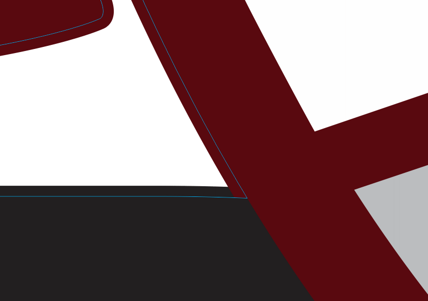

I do have one repeat order that has this, I just hand built the bleed and contour lines, stacked over one another in some way to make them align properly at the intersection.
