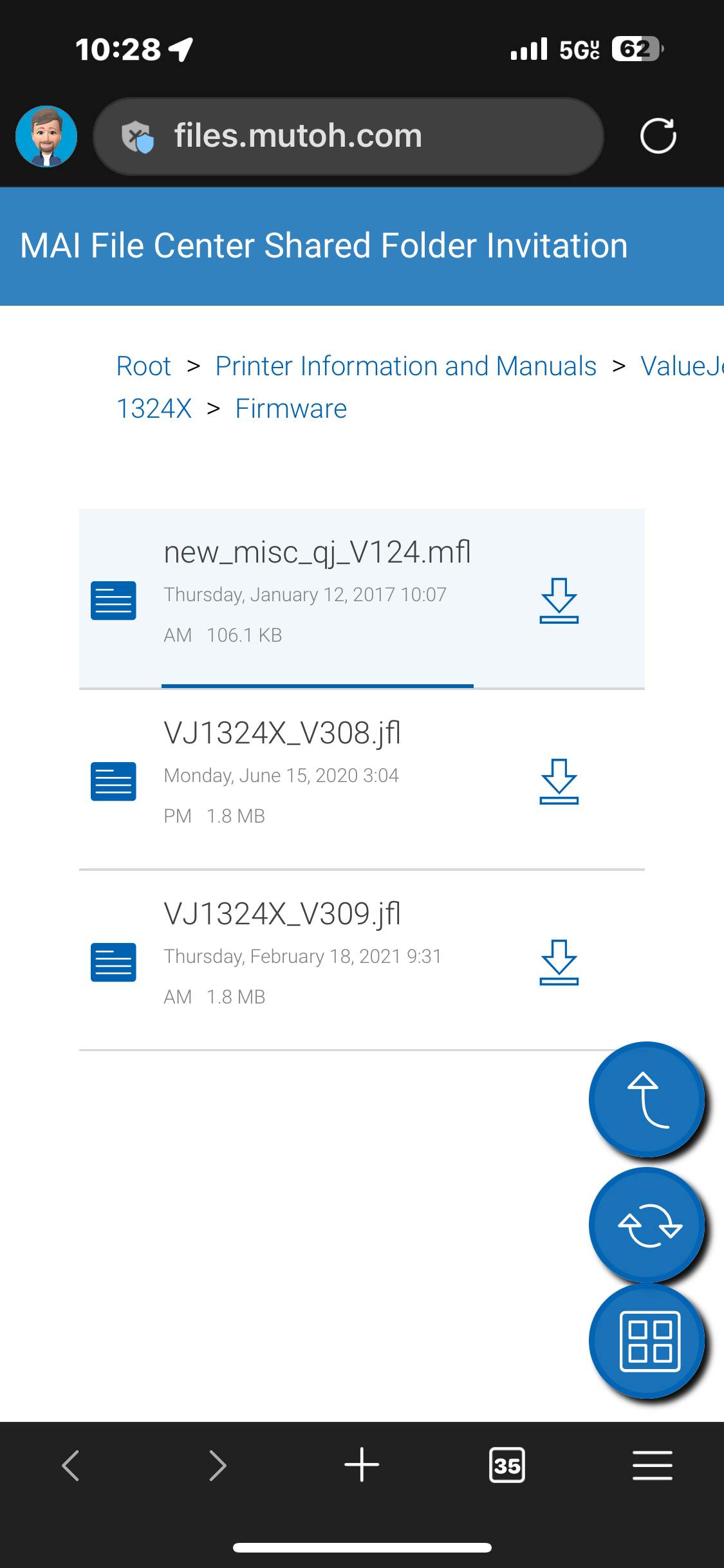

Resetting Lifetime All will screw up all kinds of things Never do that. Only the function that needs resetting. That is why I guide users through it
