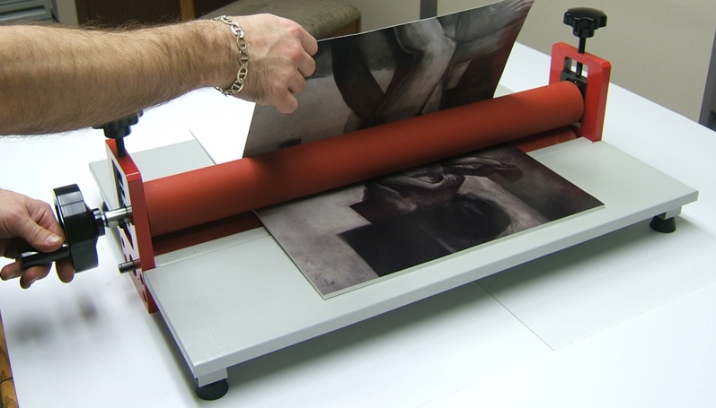

If all your stuff is going to be small you should be able to get by with a hand cranked laminator like they use in photo print shops (if there is still such a shop)

As Wayne suggested a high quality hand laminator should suffice nicely.

Hand crank laminator really seems to be the way to go. Applying it by hand with a squeegee has been... frustrating.
