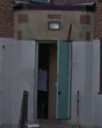

    So, i have to install 100 signs on motor. mostly small signs, 10"x30" long. its going in a "section 8" housing area and am worried about vandals if i use screws..
    could i use this tool? would i need to use something else so i will not damage the aluminum? its .040 gauge metal and don't want the finish to get marred.
    i would assume i need to pre-drill the aluminum holes and hold the sign on the building and "Shoot" the fastener into the masonry....
    thanks for your input!

    ummmm, NO
    maybe for cast block, but mortar lines?!? heck no, you'll blow that thing out.
    get a hammerdrill & security screws or rivots or use VHB tape & silicone.

    the area where the signs are going would be over the front door, which has a white slab area. this is not the "motor" lines sandwiched between the brick...
    -mosher

    Screen shot 2013-09-16 at 9.56.55 AM.jpg see pic!

    I'd use the fasteners John showed. Those damn things SUCK to get out. Please don't use silicone. That stuff ruins the looks of buildings if the signs ever have to come down.
    With 100 of them to install if you don't have a damn good hammer drill go rent one. Over the course of 400-600 holes it will pay for itself in the time you'll save.
