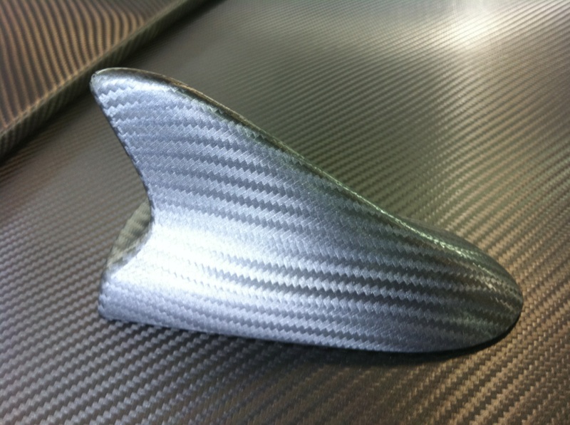

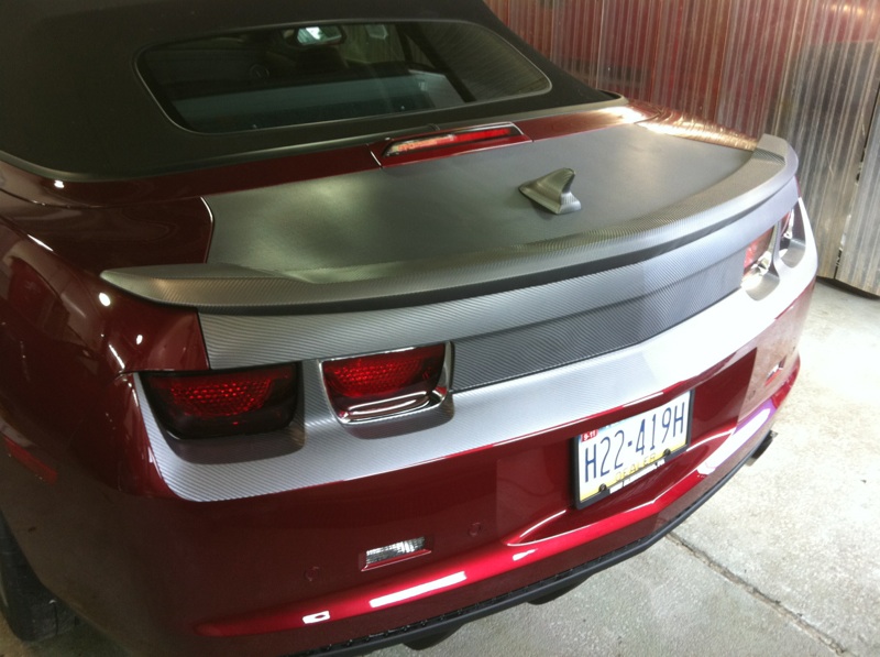

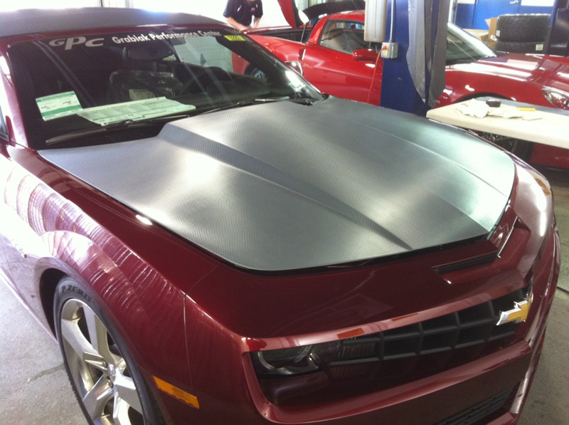

Sorry for the delay. Pics of the Porsche GT3 car that we wrapped (the silver is Oracal, carbon is 3M), and a 2011 Camaro convertible I did this morning.

kstom,
your installs look really good.
Is that shark fin antenna one piece?
Overall I am not a fan of the finished look.
I'm sure many go for that look, I just not one of them.
