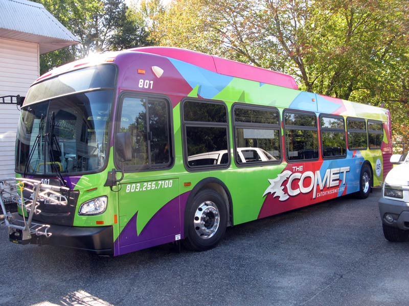

Have not noticed that here (not yet anyways) and we have literally used a TON of it. I wonder if its a bad batch? We have been liking it better than the CV3. We are wrapping 39 new 2017 New Flyer Excelsior city buses and are on the final stretch now with 6 left to go. Interesting contract too - spec'd with 3M 180, 8548G lam, 680CR reflective overlays (same lam), and 3690LF (basically the same as the new 180 LSE at 25% less cost) with 8518 for the inside ceiling also being fully wrapped. Not had any issues with the material other than 3M's terrible packaging and the stupid core tube being 1/4 to 3/8 of an inch longer than the vinyl. The poor core supports and longer tube causes the material to telescope in the boxes and mushes the edges of the rolls up some which is very aggravating but the material overall has seemed fine otherwise.
