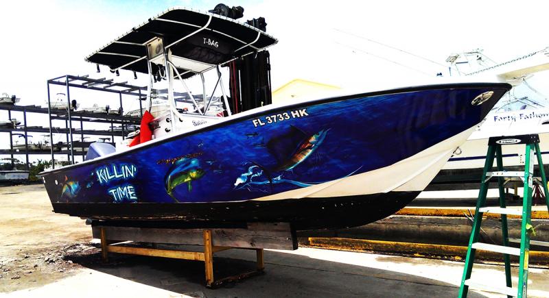

I used the 3M IJ180Cv3-10 with 8519 Laminate..
Printed on a Mutoh Eco Solvent printer.. Let it sit for two days (laying out flat across the shop upstairs in the storage room (air conditioned, not humid) and then laminated 48 hours later..)
Installed 3 days later on a flat boat after cleaning with dawn dish soap, and then alcohol.. Then sealed the edges.. The boat was about a year old, no chips, hasn't ever been waxed...
Now the wrap is getting TONS of little bubbles in it and I'm about to be out $1200 bucks in materials to redo it...
Anyone have ANY idea what would do this?

I'm thinking vinyl failure in the laminate.. I found out its the laminate pulling off of the vinyl.. Weird...
I went out to look at it today and The vinyl is down but the laminate is lifting...
