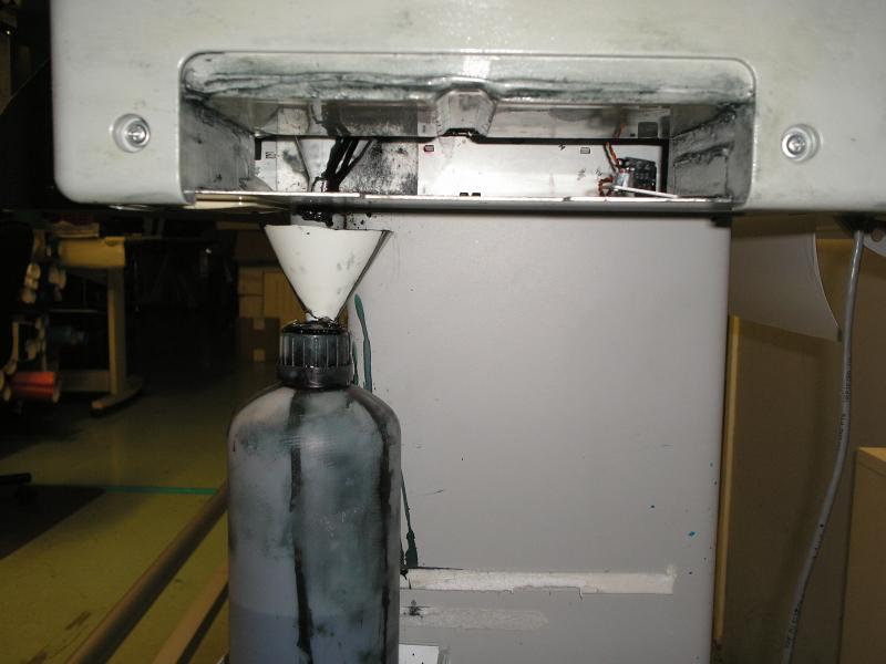

Here is a rigged waste ink bottle system for 1204. no tray or pads.

I was actually thinking the same thing and putting a tube at the end of the funnel to channel the ink to a bottle behind the machine out of sight.
