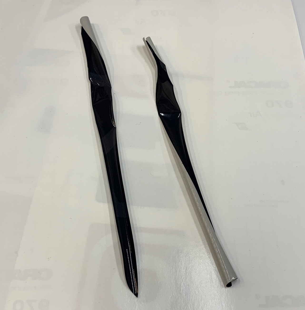

I printed some Avery 1104 cast wrap material on Friday, left it over the weekend to dry.
Cuting strips out of it results in this....Surelythe ink is not drying if it curls up on itself like this?

Weekend is long enough to outgas usually, but uh, is that laminated? I don't have experience with 1104, but we have never had that issue with 1105. Looks like so much ink :O

That's unlaminated, I doubt it would do that laminated but surely it means the solvent is still in the vinyl which is putting some tension on the material....
This was done using an IJ180 profile and an Orajet 3951 profile

We've had our avery 2611 do that printing at 100%C 100%M 100%Y 100%K, curled right up. Profile was messed up
(Specifically, we had a work placement from a local school, he said "we always print 100% everything for black!", but the vinyl limit was 250% and the profile didn't prevent it from laying it on thick)
