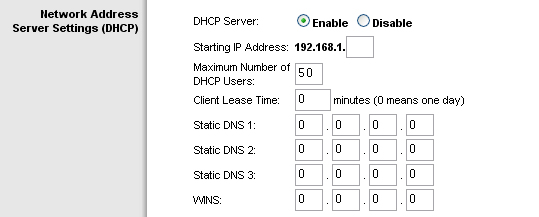

I can get into my router no peoblem..
I can set up a DHCP for a static IP but I don't want to mess with it unless I know I will need to do that.
I can also do a bunch of stuff with the router settings however their all set to default now.

shouldn't harm anything to modify these settings . . . You can always undo it !
add the static IP and see what happens . . .

OK I'll try that.
I tryed that and it said, "Invalid IP"
So I pinged it and the ping came back just fine , No lost packets

Derf can you assign a static ip on you printer? if so you need to set that ip with in the range that your router is setting/looking for.
