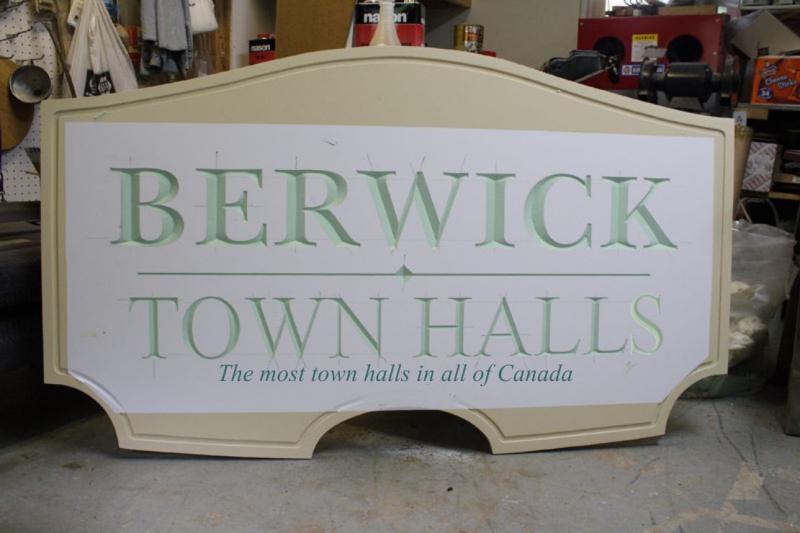

SignManiac
Easy Fix!!!

signmeup
Signmaniac.....that's some funny chit! bob was right as usual! Thanks for posting that up....it does make a person feel a little better about screwing up when you can laugh it off.

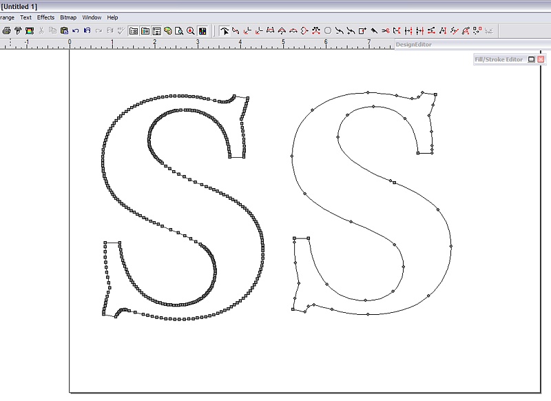

People keep saying they get good results using copy-n- paste from Corel into Flexi, but I don't think it is a good idea.
Example - S converted to curves in Corel - 43 nodes
Copy/paste from corel to flexi - 387 nodes
Export from Corel as .ai(v3) Import into flexi - 43 nodes.
Which one has a greater chance of screwing up during printing, plotting or routing....

signmeup
I'll be darned. Wayne you may have something there. I get the same result you did when I save as a cmx....hardly ant nodes. when I copy paste....tons of nodes. I'll see what happens when I send it to the plotter.
Seems to cut the same. I couldn't tell any difference. My troubles were that I didn't convert to curves and when I exported to cmx I sent a font along with the same word converted to curves. It came through with the font screwwy and the curves just fine. Interestingly Flexi was unable to locate the font I just typed out in Corel and attempted to substitute arial for Baskerville bold. I chose Baskerville from the drop down choices provided and it opened with the font I started with. It appears flexi is unable to locate all the fonts on my system. The cut and paste operation discards kerning and also reverts to standard weight from bold. Any ideas what that is about? If it didn't do that all would be right with my prefered, lazy import method.

Wayne is right... I ALWAYS export as a CMX into Flexi and cuts right everytime. BUT I also do a sample of CMX, DXF, and EPS just to see the minute differences.
signmeup
I've done the copy paste thing for the past 5 years with no trouble except for when I forget to convert to curves. I get the same error with fonts if I forget to convert to curves when I save as cmx though so I see no advantage to the extra steps.
GAC05
Quit buggin' me
I think everything gets converted to short polylines when it is sent to the plotter but I would rather have the dedicated sign app do the conversion instead of the windows clipboard.
I'm thinking with that many stacked points - the chances of stray points out of place or disconnected or Flexi choking on a complex file with a lot of converted text has to be an issue.
I've noticed that without converting to curves Flexi will import the text but change out the formatting to the Flexi default - so even the font changes at times.
One other advantage is you have an ai/eps copy of your file that can be read in most any vector program - unlike the .fs or .cdr that are proprietary.
I just don't like all those extra points so I use copy n paste for building up the files within Corel - before export.
