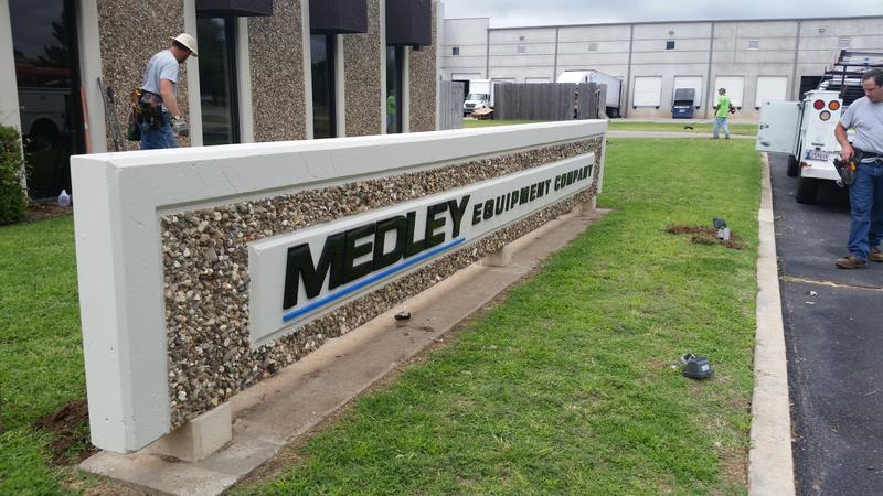

Im installing 3/4in and 1/2in acrylic letters to a painted cement outdoor monument sign.
The 3/4in letters are 9.5in tall and the 1/2in letters are 5.5in tall....Not stud mounted.
What would you suggest for adhesive?
I was going to use VHB and silicone....thoughts?

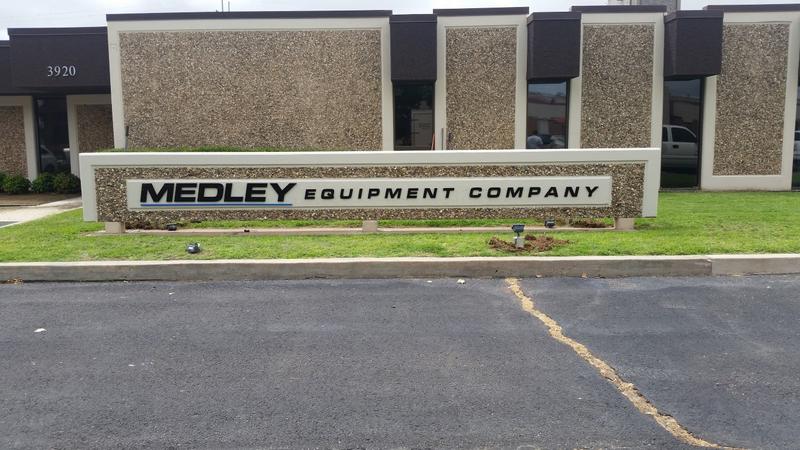

Thanks for the suggestions.... I used VHB and Lexel...came out great!

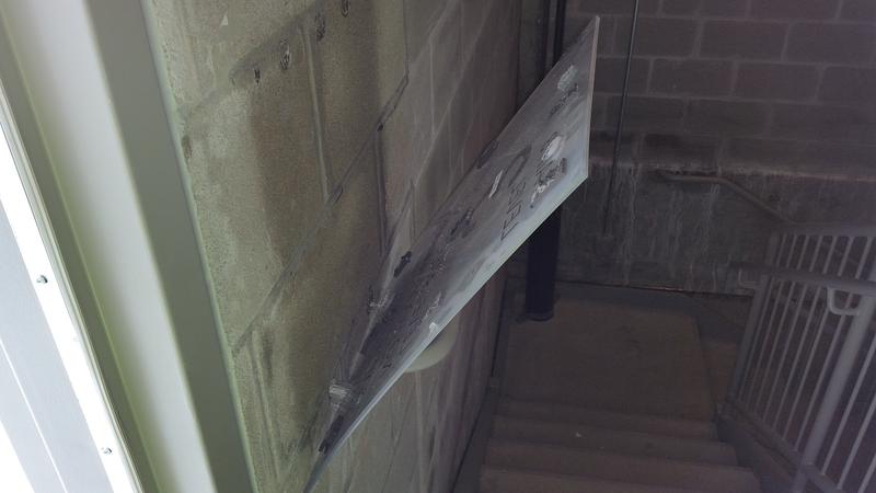

I posted this a while ago, but this is a picture of an acrylic panel that was adhered to concrete that had to be replaced.
