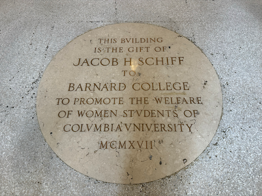

I’ve been approached for a project that involves insetting brass letters into two 54-inch-wide marble circles in a lobby. The marble is part of the existing floor, and the brass letters need to match the style of an existing inset lettering design (photos provided by the client).
Here’s what I’m trying to figure out:
1. Marble Removal vs. On-Site Work:
The marble circles are fixed into the floor. Is it better to remove them for CNC engraving, or should I bring a portable CNC machine to the site?
If anyone has experience with marble removal, how risky is it for a piece this size (54 inches wide) without causing damage?
2. Portable CNC Machine Recommendations:
Are there any portable CNC machines suitable for engraving large marble surfaces on-site?
If you’ve used one, how is the precision, and what should I consider during setup?
3. Brass Letter Installation:
What’s the best adhesive or securing method for inset brass letters in marble?
Are there sealing or finishing steps I should take to ensure long-term durability and match the existing look?
This is for a high-visibility project in a university building, so I’m looking for advice on achieving the best possible result. Any tips, tools, or lessons from similar projects would be greatly appreciated!
Thanks in advance for your help!

The safest, most precise, and the most economical way to do this is by abrasive water jet. Cut the marble, cut the brass, polish the brass, and then install. No two ways about it.
JB

Thank you for this.
I understand it's important to use the same equipment for cutting so it matches perfectly.

would make a circle template same height as brass letters and pour epoxy to match marble, after drying sand entire piece.

Matthews offers bronze plaques that are in-filled with a composite granite admixture. This would be the most durable long-term solution aside from using solid marble.

There's an existing marble on the floor. We will have to remove it.

Sounds like a very difficult project. I'd let an expert handle this job, without question.
General FYI: Be extremely careful with those slabs. Marble is a cross section of metamorphic rock, and those fancy marble floors were mined from the same part of a given quarry -- meaning you'll have a hell of a time finding a replacement if the slab breaks. (I've sourced replacement slabs in the past. Trust me, it's not how you want to spend your time.)

First off.. If you've not done this before.. STOP.
Stone isn't that hard to work with, but you don't get 2nd chances.
Imagine if it goes wrong?
Get someone who does this all the time to do it..
But if you want to do it in the future.. Practice.. Get a piece and try different methods on it.
Stone cracks easily, so diamond bits grind it away - it's what most of these things are done by these days. When it was originally done it probably would have been a stone mason - then inletting brass is simple. Of course if you've got a piece that's not fixed in place you can use waterjet, but then you cut out the outline completely.
As for machines.. There are a few portable cnc systems that could do it, but unless you're doing this full time - get someone else to do it.. Too many headaches for too little reward.

Unfortunately no.. I love experimenting with things - got a wide range of devices and machines..
Stone is lovely to play with, but something like that.. And so visible. Nahh.. You'd need to try a sample first - see what works best.
I'd try local stone masons - or even monumental masons. They often do such work.. The issue would probably with them doing it in situ.
If you did want to do it - I'd probably think of a shaper origin.. Use diamond bits - you have to find a way of using water to clear the area without damaging it or it's strips though.
The brass letters are easy, so don't worry about those..
