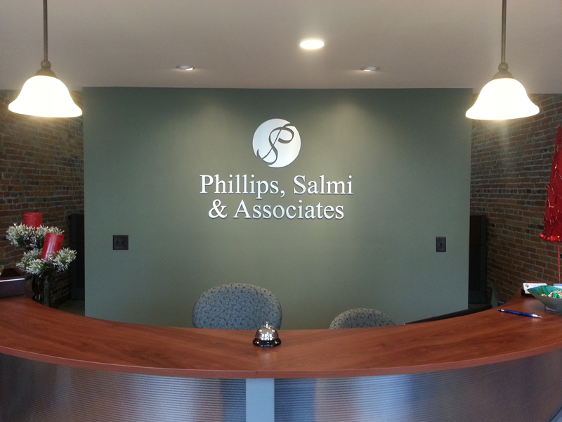

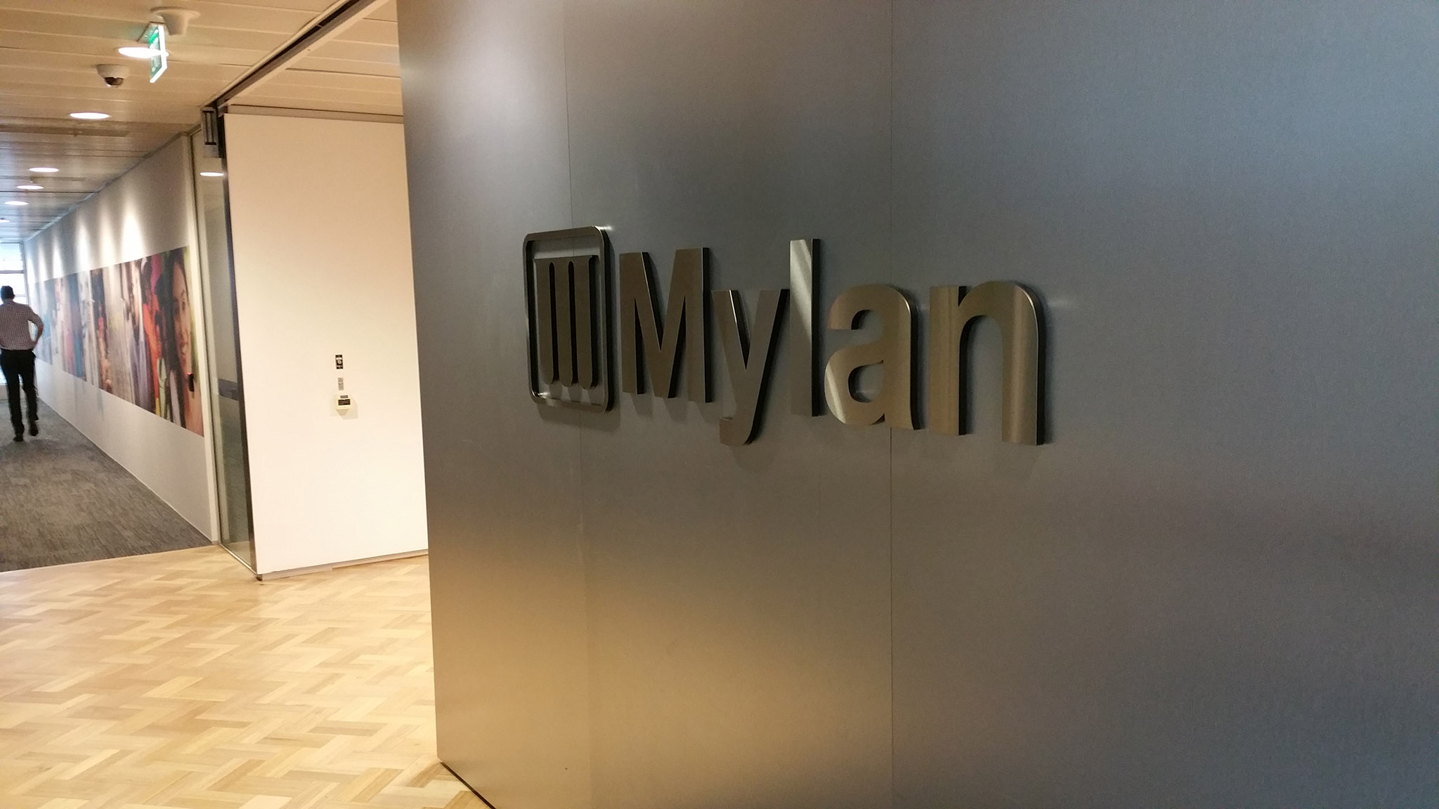

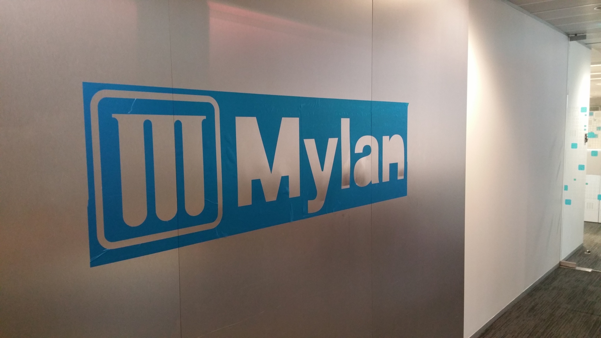

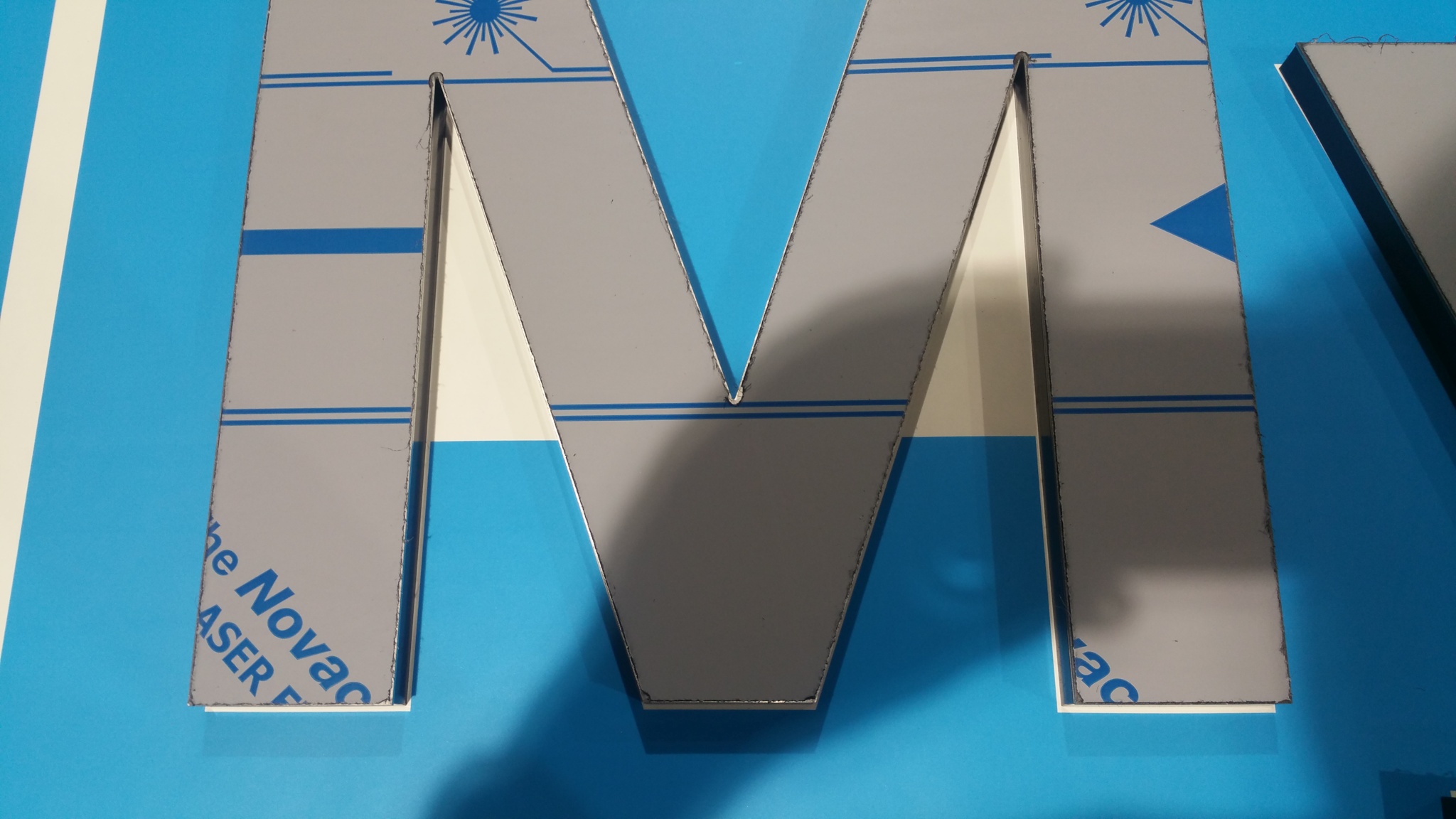

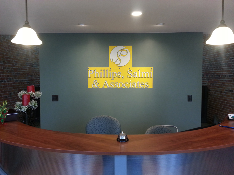

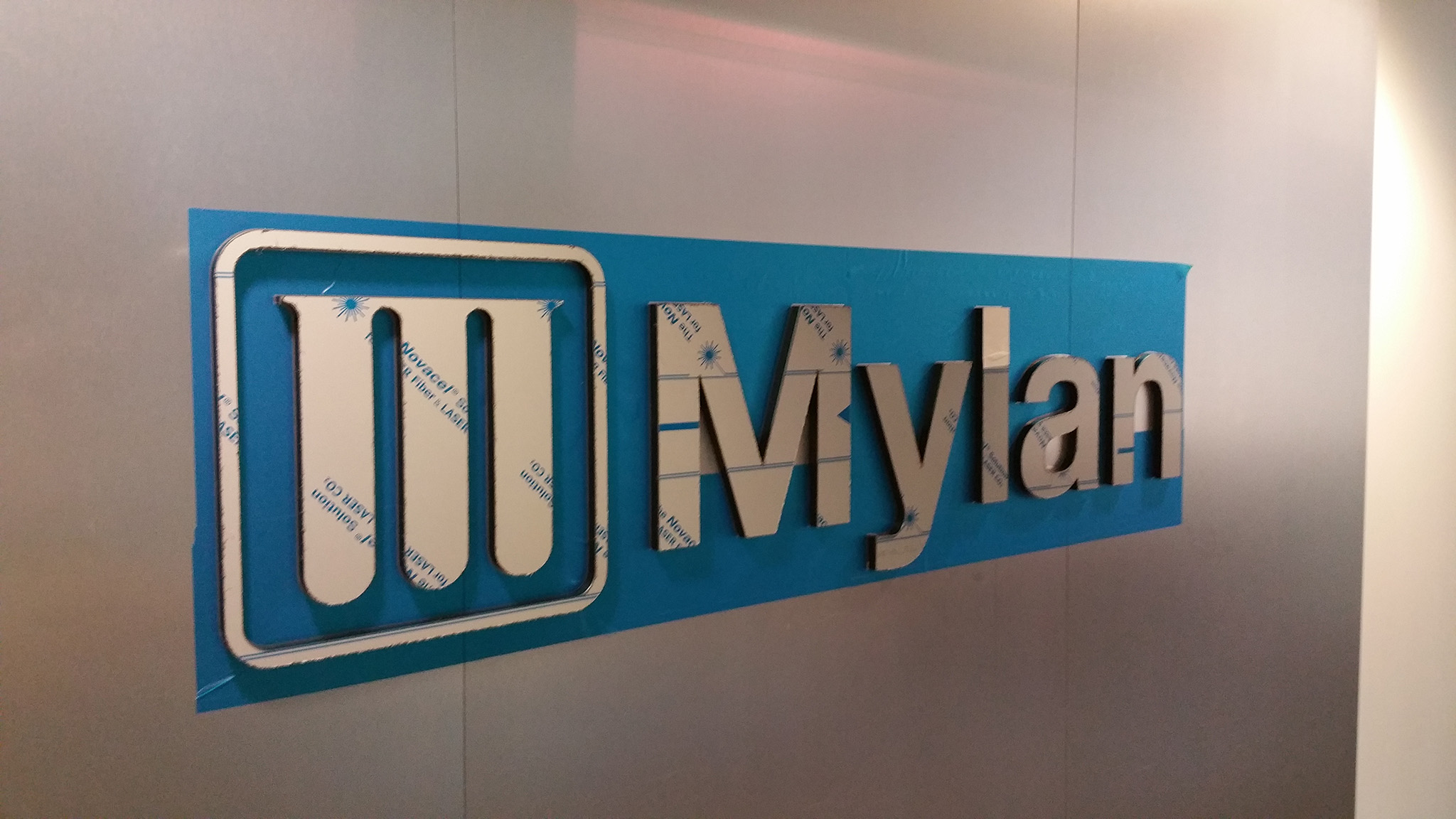

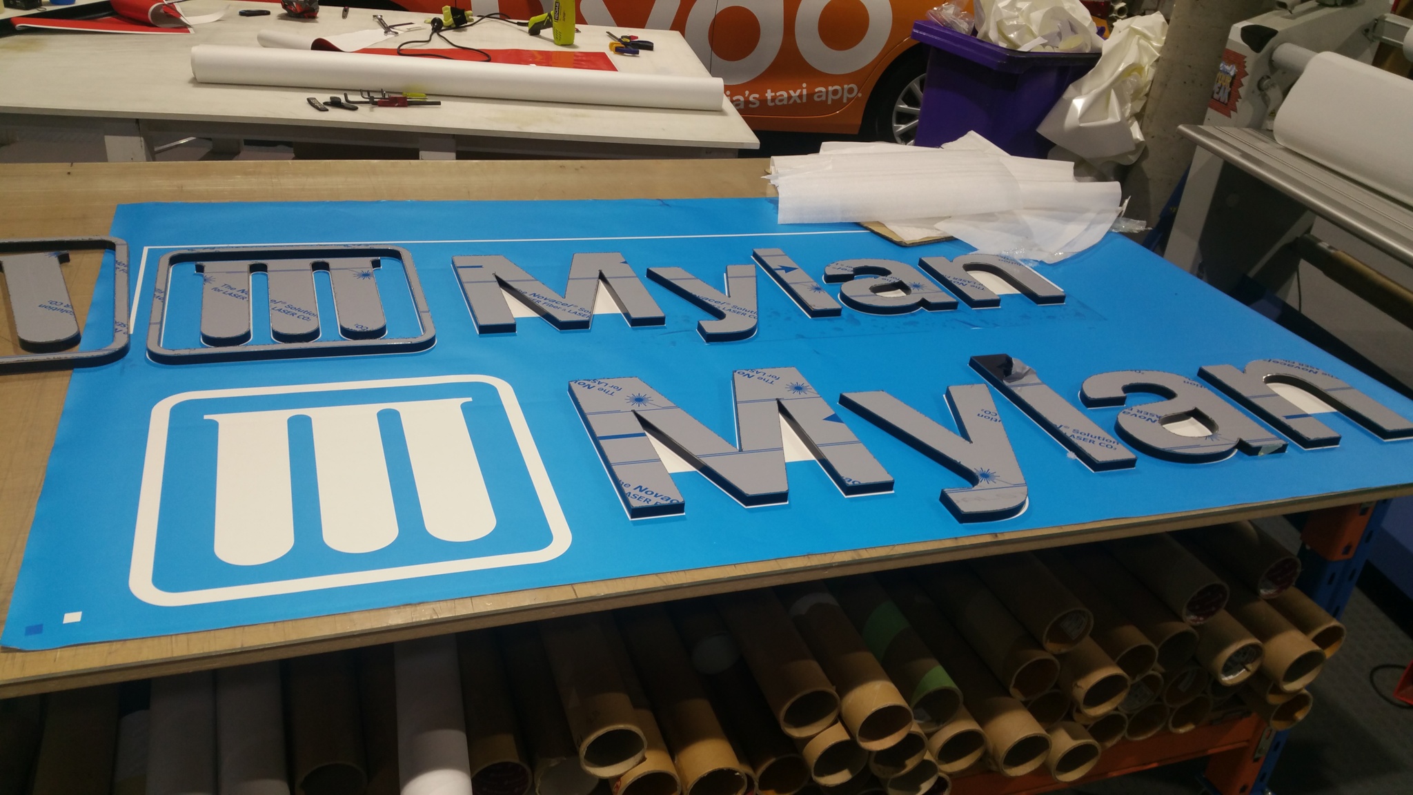

I used to do a lot of lasercut office reception logos and used low tack spray mask for a template.
Offset the path 1 or 2mm & make some horizontal cuts through so it's easier to weed out afterwards.
This right here... easiest and fastest way by far... I could produce the spray mask in a matter of minutes, make your level line on the wall, stick on, peel off low tack mask, place pieces, remove spray mask... done shouldn't take more than 15 min to get the logo on the wall.

We've done a few with a paper pattern. Instead of punching with an awl we cut out a little triangle where each corner is ahead of time. Tape the pattern in place and lightly draw the corners in with a pencil.
I've done a couple different ways, but for this particular artwork, Bills method would be the fastest (easiest), and extremely accurate with the sharp points in the logo.
signbrad
I would like to see a series of photos showing tbullos method. Or even a video. It's a little hard to visualize from just a description. But when you actually see it done you realize how slick it is.
You don't spend any less time, necessarily, because you still have to place the letters in their positions relative to each other. But the time you spend on the job is a tiny fraction of what it normally is. And if by some chance there is a screwed up letter (such as the wrong side of a letter painted by the new dude in the paint booth), you catch it in the shop, not on site.

It's really not that many pieces. You could cut a stencil-pattern. Tape it to the wall, it's as easy as putting the oval peg in the oval hole, the square peg in the square hole, etc.
This was done with stencil-cut patterns:
In cases where a paper pattern is provided, I used to cut the corners of the letters, make a pencil mark, etc., but it's pretty time consuming. I now have a small piece of wood with a very sharp brad pushed through a pilot hole. I mark the corners of the letters (or a few key areas of O's, etc.) and it makes install pretty easy. If installing larger pieces, mark where the brad marks are on the wall with a small piece of masking tape. It's easier than searching for them when you're holding a large logo.
