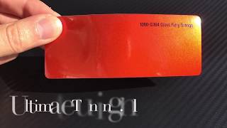

Yeah, so this is actually the color the client I have is wanting. This orange metallic effect on that material. We're trying to design a marble print on top of the orange so maybe ill work out since it's mainly black will be printing.
That could work possibly. I'd get a sample first and test it out before committing!
