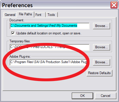

I wonder if there is a way to stop flexi from loading those plug-ins without losing all my preferences.
Yes ... just open Preferences and set the path for Adobe Plug-Ins to any empty folder.

Well, that worked!! I just went into the plug-ins folder and moved them to see.. flexi loaded up perfectly!
