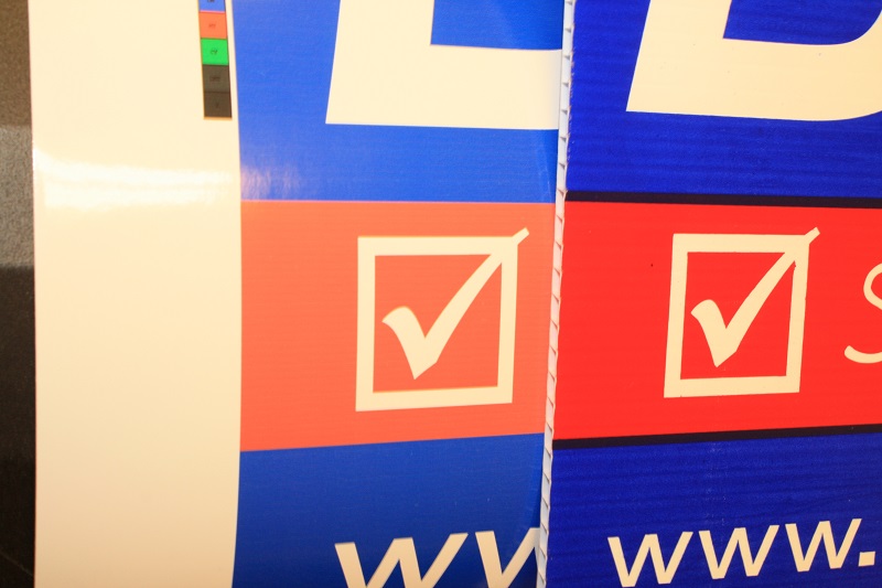

I've attached a picture to show. The left is my print, the right is what I'm trying to match. My red comes out orange and faded while my blue comes out more faded.

Alright, I printed with the perceptual intent and with an exported JPG (RGB) and it gave the results below. Still with the same issue now with the blue pretty off as well. :(
FatCat
Sorry to be late to the party. To me it seems either your ICC profiles or your print files are to blame. Both my 1204 and 1604 would have no problem hitting that blue or red on the right. Try switching from SWOP to AdobeRGB 1998 and see what that does for you.
