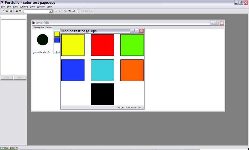

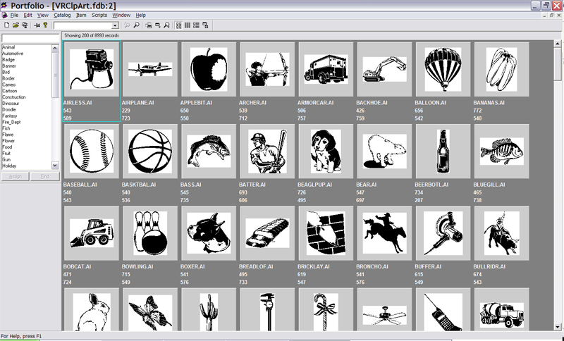

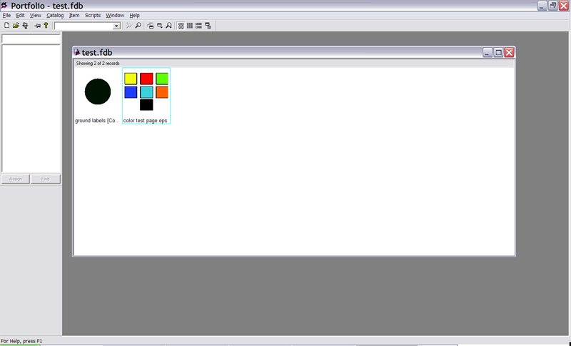

Au contraire Mon Ami ... Extensis Portfolio does not suffer from such shortcomings.
Here are screen shots of two EPS files I intentionally saved as EPS without a preview and then added to a Portfolio database. The first screen shows the thumbnail view and the second screen shows the detail view when the thumbnail is double clicked. The third screen shows a catalog I made some time ago with AI files without previews.
Of additional interest, the version of Portfolio that I am using is version 4 which is 10 years old. It will thumbnail and process the full size into a viewable JPG which can also be keyworded for searching later.

I may have to try the trial version. Does it work on files that you never created yourself? I have a cd with eps files that won't show the preview on anything until I actually resave it
Fred Weiss
Merchant Member
As a publisher of vector clipart I can tell you that the only EPS and AI you can count on to work everytime is that which has been saved from Adobe Illustrator. For example, CorelDRAW and FlexiSIGN will often fail to import their own EPS exports even though other applications will handle them okay.

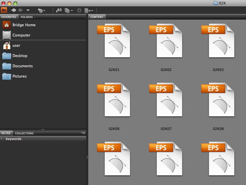

I can confirm Windows 7 does not show eps thumbs...
:rolleyes::rolleyes: Hmmm... on my Mac, I select the EPS file, press the spacebar and "poof", I have a large preview right there in front of me. Feature called quick view. Now... along the lines of what Fred said... it only seems to work with EPS created in Illy.
