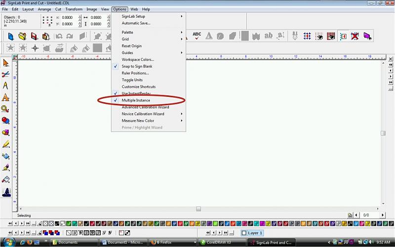

Wait, You mean we can finally have more then one job open at a time. That will be worth the $499 price alone.
d fleming
I'm running 8 on two systems and it's very nice but I have no idea how to open two jobs at once. That would be awesome, it's the one big thing I've never liked about the program.
slipperyfrog
On your top menu bar goto/check the following:
Options/Multiple Instance
signage
Multi "Instance
Here is a screen shot for multi instance: This has been available since version 7 only thing I'm not sure of is if it was available on release 1 or added at sometime with updates!
