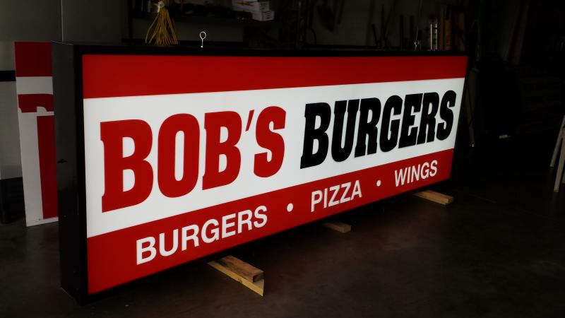

We just finished this 12' x 4' cabinet. It has a printed graphic on Avery 2050 Translucent mounted 1st surface and it has a reverse image printed on clear mounted 2nd surface. We used our laminating table. The only problem with mounting the clear using dry method is when the printed side of the clear is sliding across itself while applying. It tends to be sticky. We use a used backer paper between the surfaces and it slides with ease.
