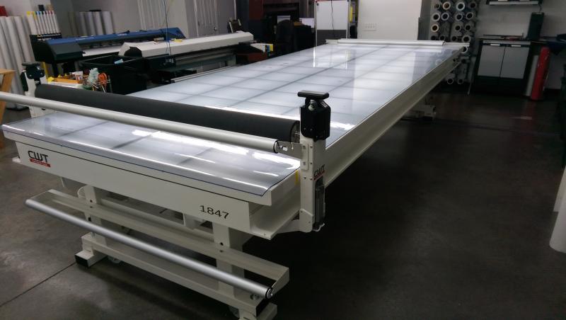

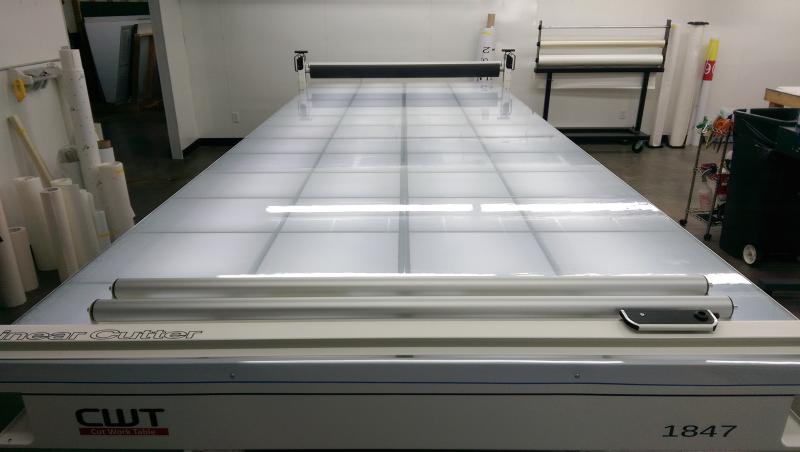

We always do a print on Avery 2050 mounted 1st surface then do a reverse image on clear mounted 2nd surface. Works every time.
We use a table to mount but a regular laminator works fine if you have a couple extra hands available. IMAG2094.jpg IMAG2089.jpg
