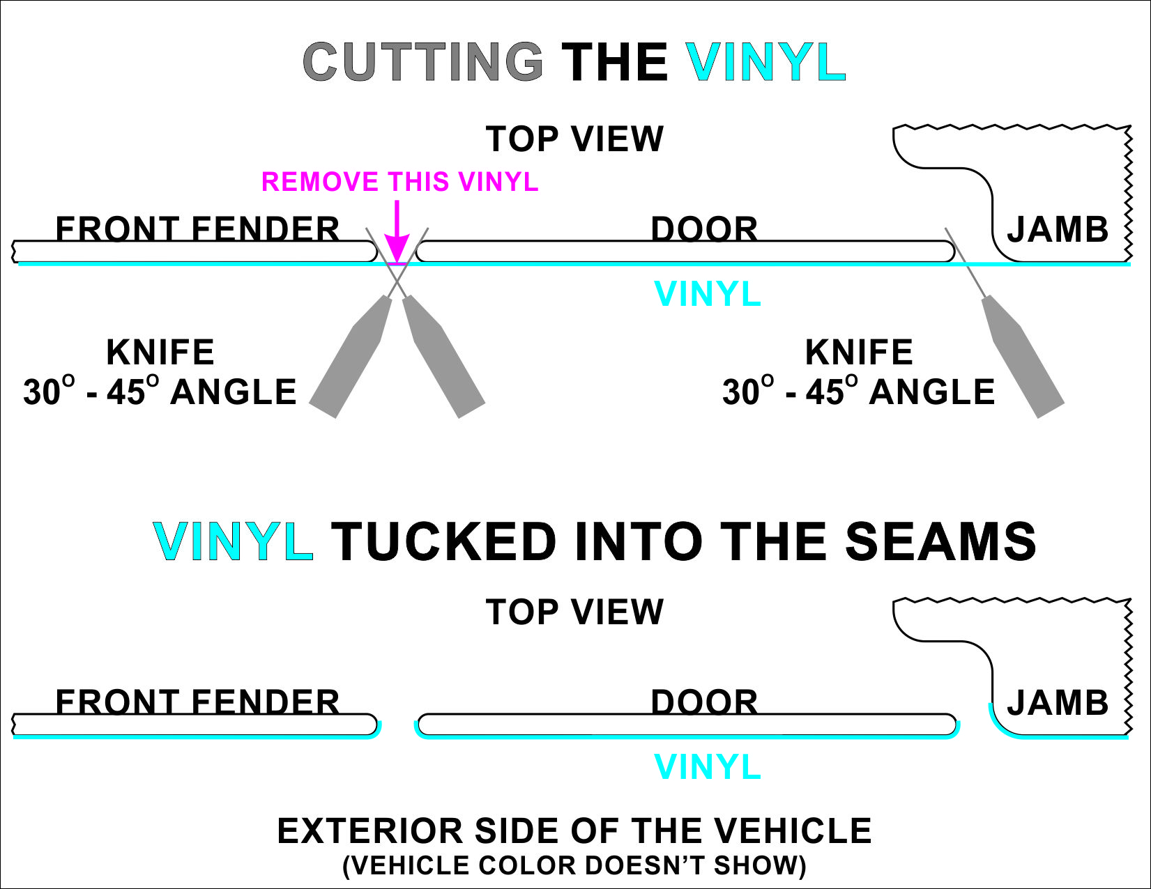

    Typically the image below shows how I trim a commercial printed wrap. For color changes you work each vehicle panel separately and wrap allot more edges. If you do wrap edges you need a 1/4" to make sure it will hold especially if it is under stress.
    • Agree Agree x 3

    Cutting at 30-45 is definitely the way to go. It gives you a bit more vinyl to tuck up and under and gives a better finished look. The SasserCut is primarily used for speed with lots of gaps like vents or for commercial/fleet wraps. It's also a fail-safe tool as it will always cut in the middle with the blade secured between the two wheel parts. The main focus of our tools is to save you time. If you're in it for the long haul, over time, these "2 second improvements" as we like to call them, all add up and make you leaner and meaner when it comes to your business. We offer the SasserCut in a Set or by itself for $38 so it isn't too much of an investment in your time. You can also just flip the Sasser around and use only the wheel to trace the groove first and then flip it around and use to cut. It's great around those circular gas doors too and with the 4.0 wheel I get great results around headlights too as the bigger wheel exposes a lot less blade. I'd also suggest a good tucking tool to finish off with. I see too many installers just use heat and their finger or a squeegee with a buffer to tuck around the edges. Typically this is a "drag" motion which is really just moving adhesive in the direction you are dragging. We have some tucking tools that are rounded specifically to "push" adhesive down and into place for a better seal over time. :)

    This should help.
    • Like Like x 1

    I never wrap around the edges more than 1/8. After 10+ years and 1000s of cars i have never had a single issue with vinyl lifting. If you do commercial wrap try to cut in an angle like how that picture was showing. With custom wraps i open the door and cut in a 90 degree angle right behind the door edge. Completely hides the original color but no need to lay more than that. If you do it just makes the removal twice as long.
