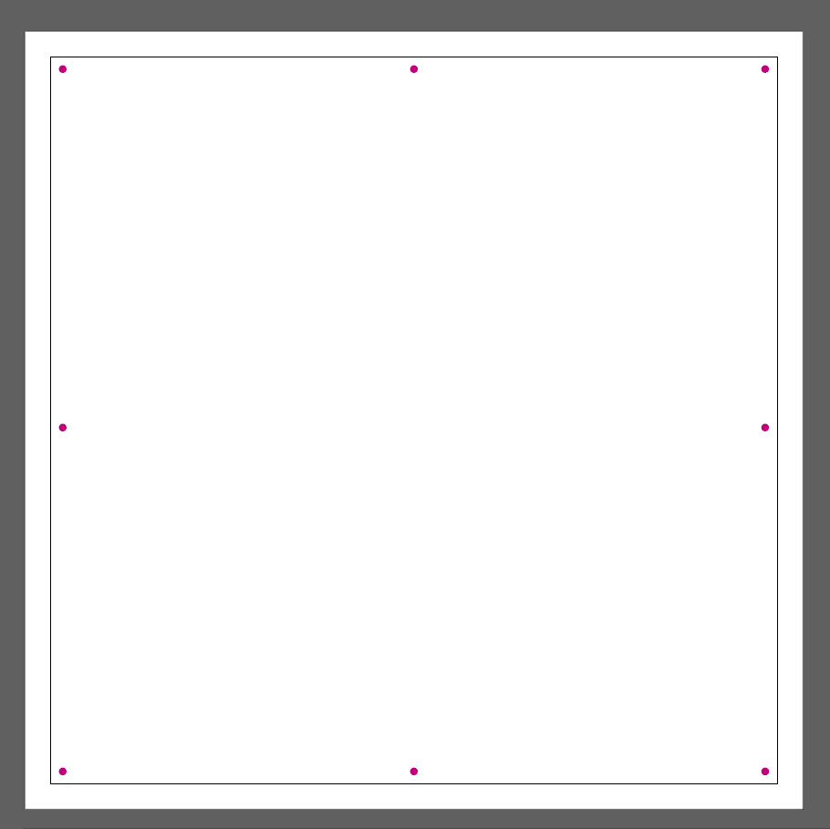

This is cool! Although I don't use it for banners since Onyx does all of that for us, is there a way to change this to put .5" dots 1" on center in corners and then add a dot and distribute if it's over 36"?
I tried messing it with it a little but everything is metric and I think i'm missing a few. I also wouldn't need any additional lines, borders or bleed, just the dots. Is there also a way to have the color a spot color rather than CMYK?
As you can tell, I don't know much about scripting. :help
I layout drill holes for photos and I have to type in the locations of the dots or copy and paste and change the size without changing the center location from the distance from the edge.
I layout drill holes for photos and I have to type in the locations of the dots or copy and paste and change the size with changing the center location from the distance from the edge.

Here is the basic concept. (PDF saved with Preserve Illustrator Editing Capabilities so if you open in Illustrator each page will be on it's own artboard.)
  • Mount Template for Script.pdf
dotdist needs to be modified to set the distance from edge - it's metric but you can use google to translate it into mm, just like the "target" which sets when the middle dot is inserted
