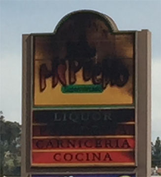

saw this sign the other day and thought of this posting.
