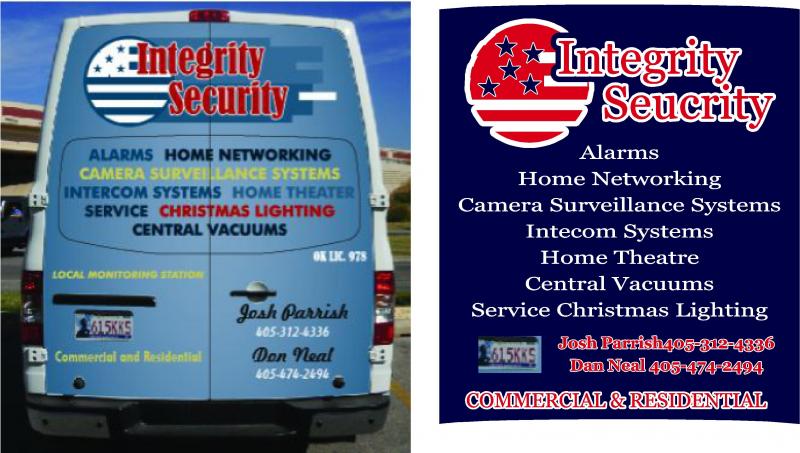

Back Door Wrap thoughts??

This is my 2c. I consider this more vinyl lettering myself but simple and with a dark blue background instead of that light blue. Simple just gets your logo and info out there. Also maybe try deducting some of the items if its not overly important like vacuuming? If that's not a huge part of his deal I wouldn't even list it. Try to clean it up a little make it easier to read. I drew this sample up in 5-7 minutes on flexi. Again nothing special but much more visible to read imo. Also somewhat similar to Jills. Nor did I read through all the comment either to much bickering regardless I hope you have found what your looking for

We're gonna need a bigger van.
If it looks like it was done quickly on a computer, well...
The red copy at the top in unreadable.
Nobody is going to scan down to, "christmas lights" ?
Or, bother with the phone number that appears to be an afterthought.
There is an art to guiding your customer into what they NEED.
(logo) Co. Name
5 word tag line
Phone #
Ancillary graphics and stuff if it supports the above. ^^^
Plenty of room for artistic presentation and supporting design.
The key is 'love it at a glance'.
You have all seen one's you remember and one's you laugh at.
This is not a static ad. It is a "LOOK AT ME !" for a moment, and remember me later,
... when you need Christmas lights.

A pink van with a big a** orchid is a florist, a white van with a pipe graphic is a plumber.
Don't reinvent the wheel. Just grease the bearings. That is where your design shines.
AND - TELL YOUR CUSTOMER TO KEEP THEIR VEHICLE CLEAN !!!
Gooo on the mud flaps = Negative Opinion of the Business.
Art is SIMPLE ! (not EZ)

"Back Door Wrap" sounds like an adult entertainment DVD title.
My question is what about the rest of the van?
Is it just the rear doors that will be done?
Seems like setting up the back would be the last thing to design after the sides have been laid out so that everything works together.
If it is just the back I would put more energy into trying talk him into doing the rest of the van over stressing on rear design.
Even the best design is going to look off if it is the only thing done.

That's hilarious! He wants his logo and lic # on the sides as well. He wanted a full on wrap when I first talked to him but it didn't fit his budget, being such a huge vehicle. I suggested he just do some simple lettering on the sides to get his name out there. A couple weeks later he contacts me and says he wants to wrap the back end and do the rest later. Which we all know thats not the greatest idea. I'm trying to get him to do the back end only, nice full color logos on the side and call it quits. The vehicle is brand new, so it wouldn't look bad. The owner is a nice guy, just can't make up his mind. He contacted me yesterday and hasn't seen anything yet. Back to the drawing boards tomorrow! I assure you, when it's all said and done, the customer will be happy. Also just for my own dignity I spent more time on the clipping masks for the mock up, than the lay out before I posted that earlier. I honestly just wanted to ask what people thought about American Flag wraps, but the forum suggested I show something to get people talking. Hahaha Oh did that bite me in the ***. :smile:
Enjoy yourself. Good evening.
charliet
What budget did he give you to work with? Is it even doable?
$3000 max. It's a big vehicle, I would have to drop the sq. ft. amount to get even close to that number. Luckily it's a simpler wrap/install, so once we hit production it will move quickly. It's all up to what he wants to spend. We shall see!
