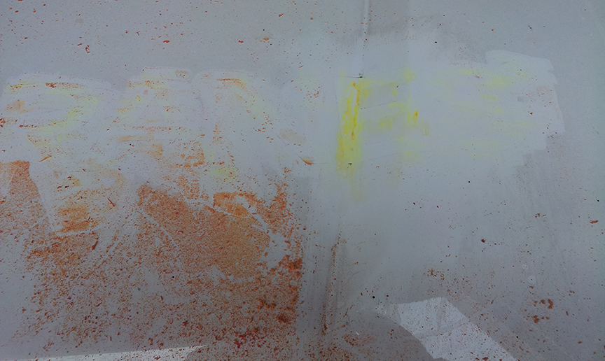

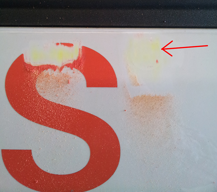

    Been using a zapper for a very long time to remove vinyl,especially hard to get off vinyl. Yesterday, I removed some dark grey from a door and went as normal, got to the red/orange vinyl and it left a stain of yellow on the paint, which I can't get out for sh!t. I'm not sure if it's a stain or the paint got burned, but I've never seen this, as long as I've been using this tool, which like I said..... is a lon-n-n-ng time.
    Any ideas. It's a brand new wheel. I might try changing out and putting another one on, but I doubt that's gonna do it.
    Everything is metal. If I use a tweezers and heat gun, it doesn't leave any yellow, but it's hard to get off zapper-grey.jpg zapper-grey.jpg , so I don't think any residue has migrated through the vinyl.
    The arrow indicates where a registered trademark was. As you can see in these photos, it's almost allows the whole thing to be read, but in yellow, instead of red.

    I'd really like to know too. I had this EXACT same issue happen a few months ago on some oil-field trucks. I tried THREE different brands of wheels and same result.
    This happened on one job site and then again on a totally different customer / location / vinyl. I even tried using a different / slower drill.
    I never worried about this in the 13+ years of using the wheels until a few months ago. Since then I stopped using the wheels

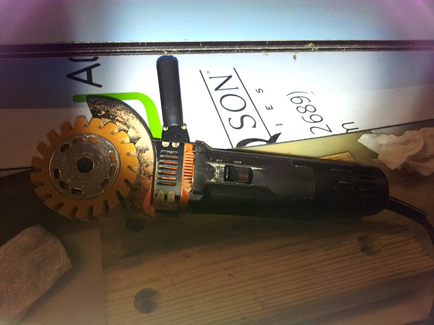

    The zapper only has two speeds..... on & off.
    I think you're talking about a wheel you put on a variable speed drill. Those are basically for removing stripes and small things, but the zapper is for just about anything, with adhesive in back of it. zapper.jpg

    Compound and wax... nothing else will get it out. I have that happen quite a bit.. the paint is actually cooking a little, just more noticeable on a white vehicle.

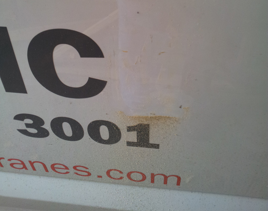

    I used the 3M eraser wheel on an old Mack semi with some vinyl that appeared to be metallic silver and I would guess it was nearly as old as the truck judging by it's nearly disintegrated appearance. It left a slight discoloration on the royal blue paint also that couldn't be removed. The customer was okay with it due to the age and condition of the truck, so I left it as was and applied new decals right over the top of it.

    No, it's not smeared, not really at all. Where the red lettering WAS, it now looks like a yellow transparent letter. It takes on the shape of whatever was there before.

    In regards to "Speed".... slower speed of the wheel is helpful in some cases. The "Zapper" being a single-speed (high-speed) unit, works okay in most cases but can be a problem in others. There are a few pneumatic (air powered) versions of the "Zapper" style unit (using the same eraser wheel) available on the market. Personally, I prefer the Snap-On® tools ("CrudThug") version. Other brands/models may be found through automotive tool suppliers. These units are a bit smaller, lighter, have a variable speed trigger, and no excess heat up. Yes, it can be an issue if you don't have a source of air.
    Those rinky-dink wheels that attach to a drill or die-grinder are far too hard and are made for very small vinyl pinstripes or lettering. Those will burn paint and/or clear-coat very quickly if used improperly. Any of the erasers need to be used at a proper speed relative to type and color of vinyl, base finish (factory vs. repaint) that vinyl is being removed from as well as surface temperature. Most importantly... don't linger the wheel in any one area! Keep it moving.

    You know, after thinking about it I have had this happen on white trucks also. Not as bad as what you have there, but a faint yellow... usually behind red vinyl. It also almost always happens behind the vinyl encapsulated 23 kt. gold leaf graphics I take off if they are on white paint, whether I use the eraser wheel or heat and pull. I always figured that was the gold size migrating through the vinyl. It may not have anything to do with it, but I don’t recall it happening recently since I switched to the Dynabrade RedTred eraser wheel on a 7” variable speed polisher/grinder. And a side note... these DynaBrade grinder style wheels work much better in my opinion.
