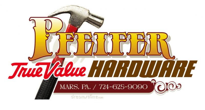

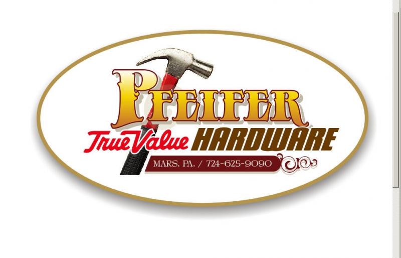

Jill, seeing that you did the second layout three years ago, what would you do today if given complete free rein and blank canvas? Would enjoy seeing the progression through today. Your work has definitely improved over the past several years from what I've seen on this site! :)
SignosaurusRex
...Oooops! I did not realize that second layout was three years old....You are so far better than that now. Ditto...on seeing a progression through today!
Marlene
To me, the layout is relying too heavily on clipart scrolls for an antique-y feel and I wish he wouldn't have liked it so much. I kinda prefer the old layout, with a tweak or two.
agree with you as there is way too much going on. the shapes within the letters would have been enough and the extra scrolls just clutter things up. I also like the one hammer rather than the two. seems like every guy off the street wants two of something with their name on an arc. at least there's no arc. just for the fun of it since you did this 3 years, what would this look like if you could re-design it and if you were free to set it up the way you'd like to see it?

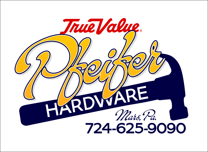

If I could re-do it it would be along the lines of this thing.
:smile:
I do appreciate the critique and agree with it.
I don't like the golden yellow that much but these are his colors.

that looks so much better and using the hammer as an underline and place to put copy really gives it a purpose past just an image.
:smile:
that layout I wouldn't do a white border and grey drop shadow on the pfeifer. The text alone should be able to stand apart on that one which it can easily do without something to muddy the colors visually. also I probably wouldn't use yellow ... a gold, orange-ish yellow or copper would probably contrast a little better without being too much 'LOOK AT ME AND STAY LOOKING AT ME'
alright I lied, I probably would do the drop shadow, but in a different way.

I don't like using the True Value script with a script.
But it has to be on the door.

I'd prefer not using a hammer but if forced to, I'd try something along this line. I just grabbed a hammer but I think an illustration done well, it might work. This is just a concept but with some tweaking, I think it could be made to work okay.
Just another direction.

I like the retro look of your HARDWARE
I did have one hammer initially but to him two hammers were better than just one!
