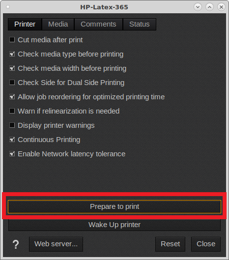

I realize it will fit any decent PC, I was just referencing the Mac mini being double and likely a year warranty. RIP times were not excessive on our previous Caldara, more annoying was the 5 minute warm up time to print after RIPPING, hopefully the new HP latex has figured a way to start the warm up during the RIPPING, that would be a time saver.

Caldera has had this button for a long long time. You press it when you want to start the heating.
Still same with L700 but on that the cleaning takes longer than heating.
And if you send the job with "Print" action, it will start the warm-up as soon as you hit that button.
The ripping happens on the background at the same time. Don't use "Rip then print" if you dislike waiting.
