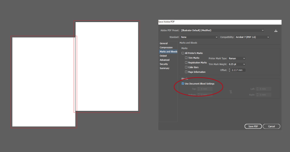

I always set up my files in illustrator and save as PDF, the artboards are your tiles, the bleed is your overlap, save as pdf send it to RIP, done. I don't like setting it up in RIP as I worked with many brands and don't want to learn a new one every time there's a new printer. Plus you can print your PDF's on your desktop printer to double check if overlap or overall look is ok.
I should know this, but didn't know you can set a bleed in illustrator?

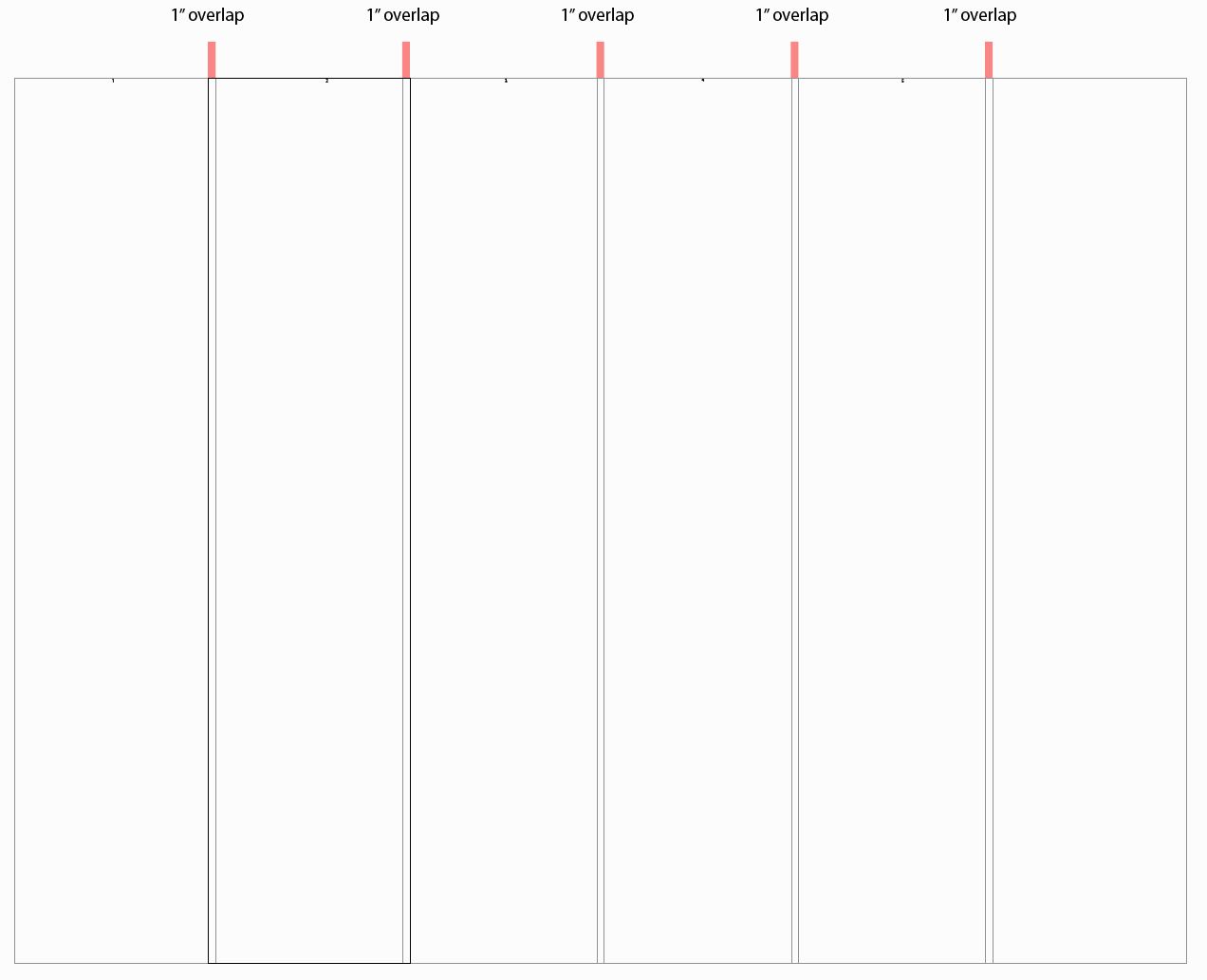

this is how I do it in illustrator. Template makes it so easy. When I had onyx training we went through tiling in the rip and in the end the illustrator templates end up being more efficient for what I'm doing
single panel reprints or printing entire set of panels weeks/month later is a breeze
You don't need templates, your bleed is the overlap if you select it when saving your PDF
There is very little use info around about illu templates. So I don't know about it.
If you now have 10x15 that you have to tile you use that template. Then if you next have a 18x5 can you again use the same template? Is it size variable so it will create or remove tiles based on the size?

Different sizes are no problem. You just drop the image into the template and save the artboards that you need to pdf. Size is easy to adjust
Contour cut lines, registration marks etc can also be in the template. I'm waiting on delivery on a Colex and I've had knowledgeable people tell there are big shops that use illustrator templates to set up their cutting and registration marks. Right now we are trimming the panels manually
I'm printing (5) 60" x 100ft rolls per day this way containing 10-15 walls. All are custom sizes and takes about 1hr to get all the files prepped in illustrator (including adjusting the design to the needed size)
