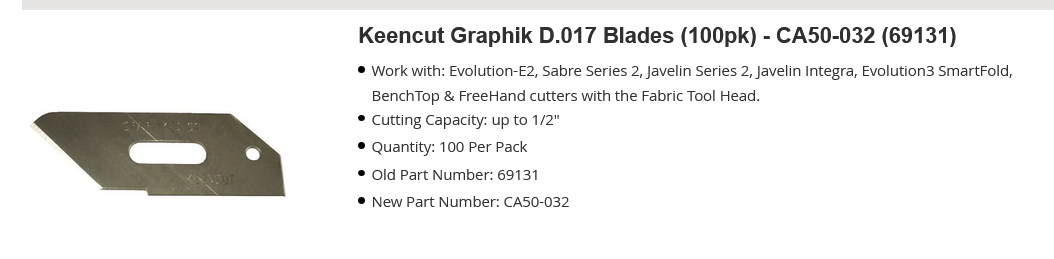

We have always used a Safety Speed Cut panel saw with a blade with lots of teeth but you usually have to file the cut edge a little because of burrs left by the blade especially as the blade gets older...
It is super accurate tho especially when cutting multiple panes of the same measurements...
However we also have a Javelin that we have had for years...probably a 1st Gen...that we use for other materials...
Am I correct that I am reading posts here that people are using a similar tool for cutting 3mm MaxMetal/Signabond...?
If so...is there a special alternative blade attachment or do you use the same razor that is normally in it...?
Is that what this blade is used for...and if so...will it fit in a Series 1 Javelin I wonder...?
