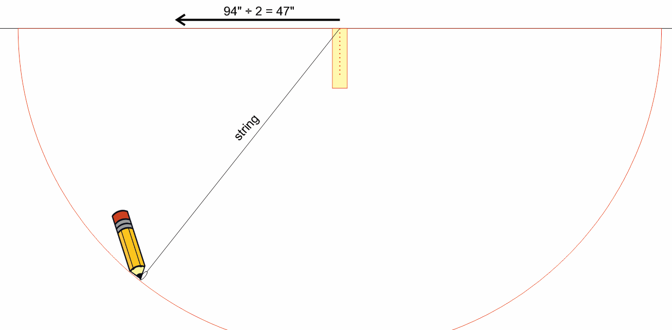

    tape a piece of string to the center edge of a sheet of pvc. Make a loop at the other end at exactly 47". Put a pencil tip inside the loop and trace the half circle. Cut & repeat
    • Like Like x 3

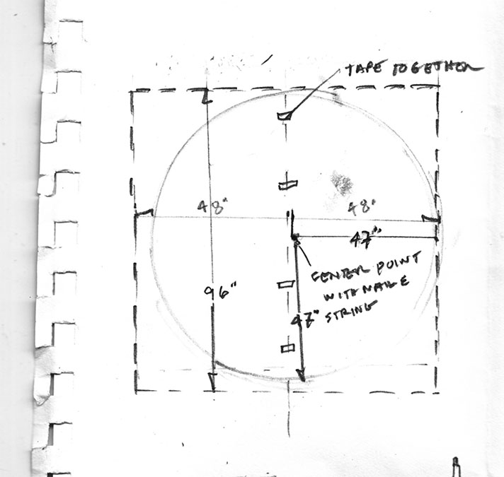

    • Like Like x 2
