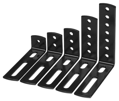

Clips like the small one on the end would work fine. Screws could be any zinc coated and attached on the inside. If you can't get to them, use a good self tapper... and plenty of them. Attach the face with some small self tappers.

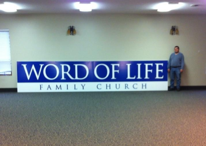

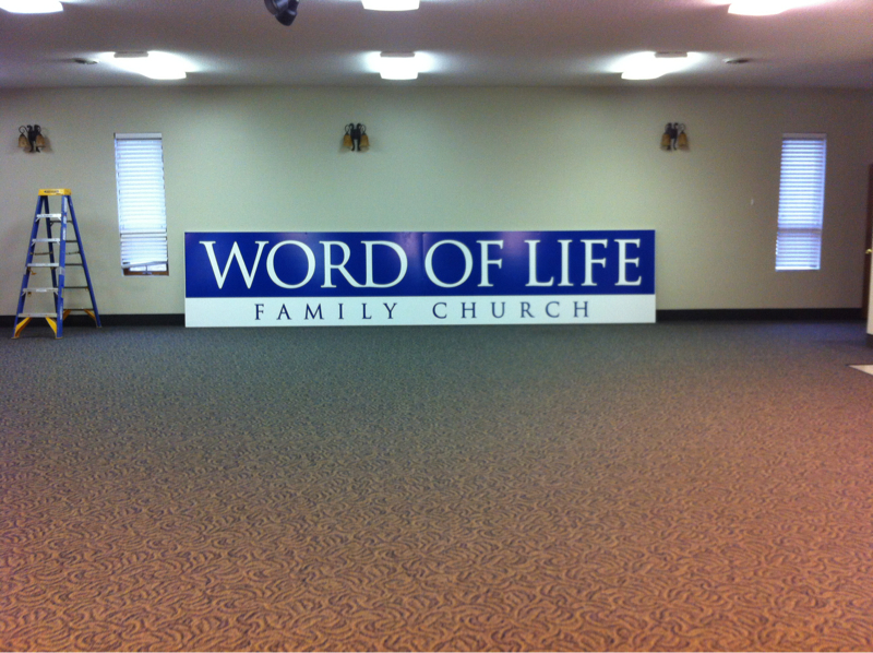

Got it all together, time to mount it on the wall, thanks everyone!

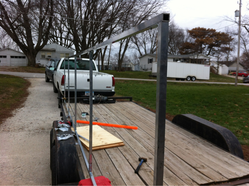

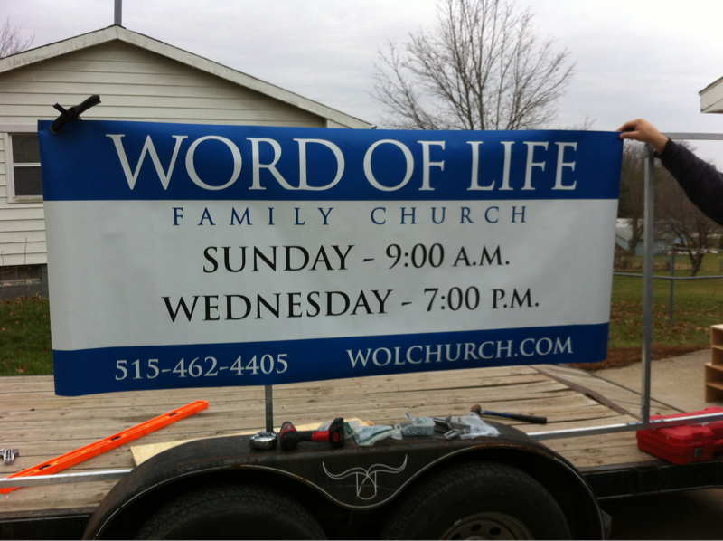

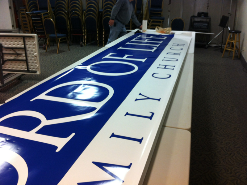

Some more
Pics and a banner
