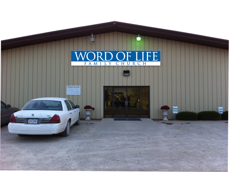

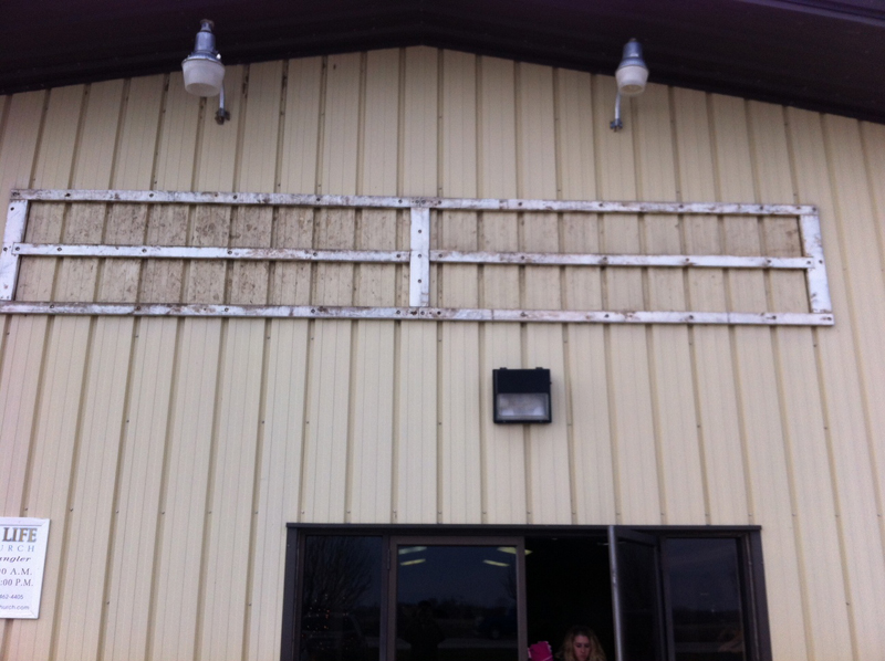

some pics of before after and during
Not that it should have mattered for this thread but for the record my Pastor has never asked me for a deal or a favor and has always made it very clear to charge him full price. I want to save my church money, I don't see what the big deal is with that. Not everything is about making money, I make signs because I love to do it not because I think I will get rich from it.

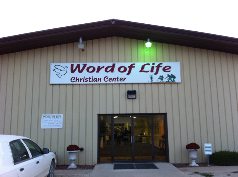

GAC05
Quit buggin' me
Looks like you got it done.
The layout is pushed a little too close to the edges, next time leave a little white space around the borders.
(That offset doorway it throwing everything off, I'd ask them to move it to the center and fix that second light.).
edit>
Ahh I think you are right Pat, the 3rd photo is the old sign?
I was going by the order of the photos posted - mock-up - frame - finished.
(can you tell it is monday morning here?)
